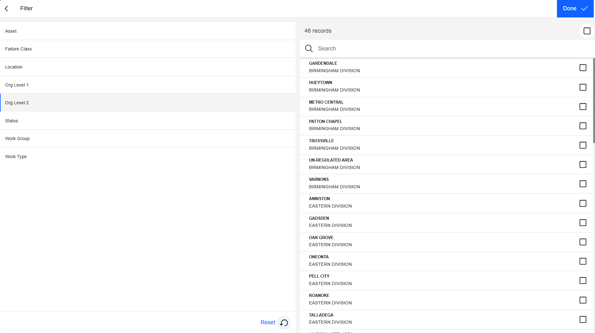

    Afturces, attributes, and looer adding the datasokup-maps for the filters I wanted to add to the Work Order List Filter screen, I was able to use the Preview option from the MAFtools application to test. Everything looked good. My lookups were displaying as expected and the json responses to populate the list from the devtools network looked good too.

    Working in preview and web when deployed:
    However, when testing on my device I see my list is showing no records, almost like they were not downloaded or not on the device. After reading through a ton of the IBM documentation there are mentions of web vs device in some places, so I am now thinking that there is something I have setup that is not compatible with the device.
