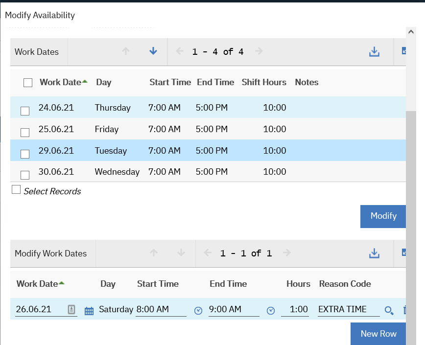

Using modify availability is your second choice. The only thing without Maximo Scheduler you are doing changes on a one-by-one basis.

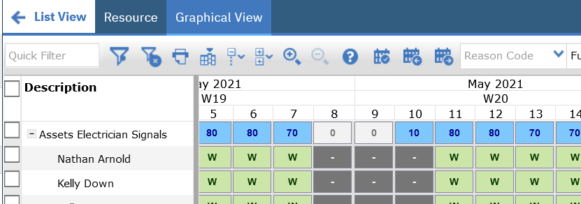

There is a third. If you have Maximo Scheduler, then my preference to use the Graphical Resource application. This allows quickly (and in bulk) apply the changes as you have described.

- Do as you suggest an interface that uploads the change to the MODAVIL object. We have done this from an HR system as the leave requests (and their cancellation) are done externally, but any extra time (OT) is done via the modify availability or Graphical Resource application.
- Do the same, but use the MX Loader
- Do the same, but use the Application Export/Import
- Create an app the looks at the MODAVAIL object and make change in that.

I like your example of the student working varied shifts. A person can only have one shift, Maximo is not built for anything else. but it is built to recognise that a shift can be made up of differing work period for a rotation. An example in the mining industry is that Type A shift works on a repeating 28-day pattern of 1-weeks on days, 1-week on evenings, and 2-weeks on night. That does necessarily help where a student may not have a fixed rotation, but that is needed when it comes to forward planning or at least it's assumed by Maximo. Using the MODAVIL with a calendar assigned and blank shift will work as you don't need to select a date in order add their shift, but the downfall is that you can't do that in bulk. So I see lots of work using this method.
