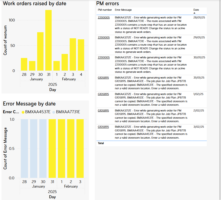

    I created a PowerBI report to provide a way of sifting through the dross from Maximo. It scans the emails and pulls out the error messages and give a us a view of how many PMs are being generated, as well as an idea of error rate, and shows when the error is being repeated because it has not been corrected yet.

    Neat! I have used a visual basic script to pick out error messages from the emails, but this was even better.
