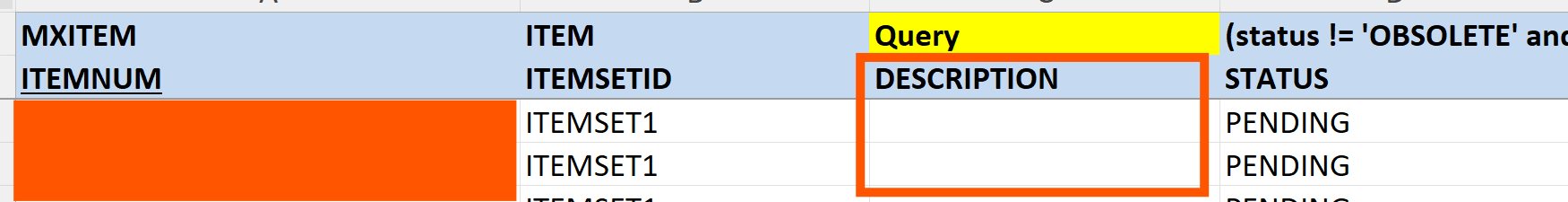

    But when I query the Description returns empty:
    Any idea what would be causing this to not return the description?
    When I create a new Item Master entry with a description it adds the description successfully, but when querying existing entries it does not return the description.

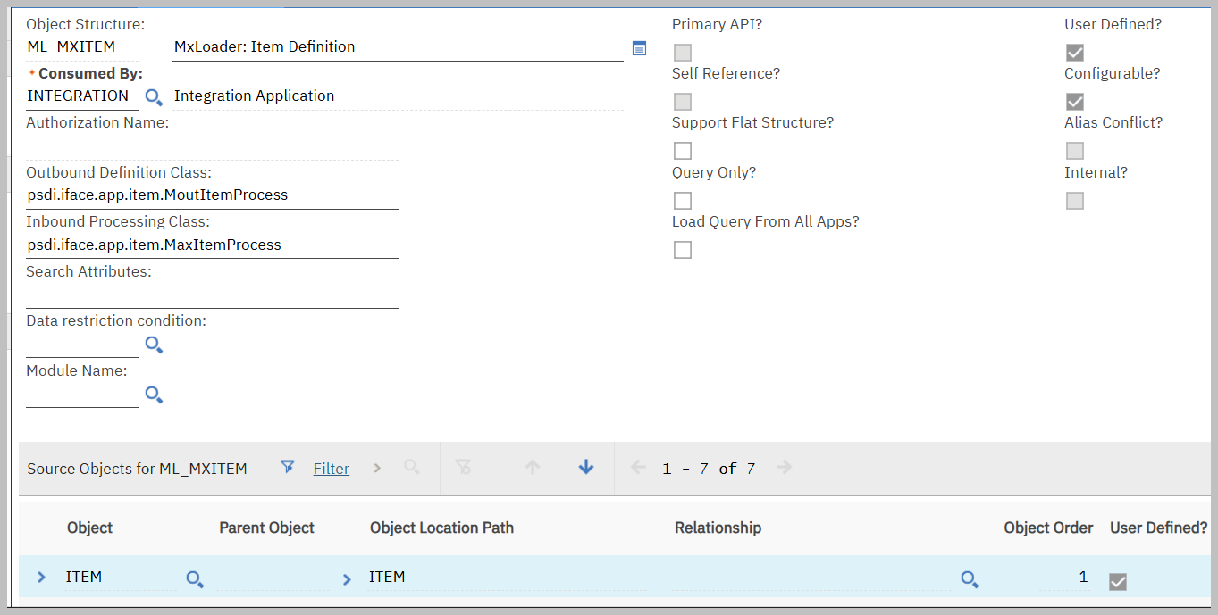

    There are ways to add additional processing on the object structure. Can you confirm the outbound definition class on MXITEM is psdi.iface.app.item.MoutItemProcess? This is the out of the box processing class.

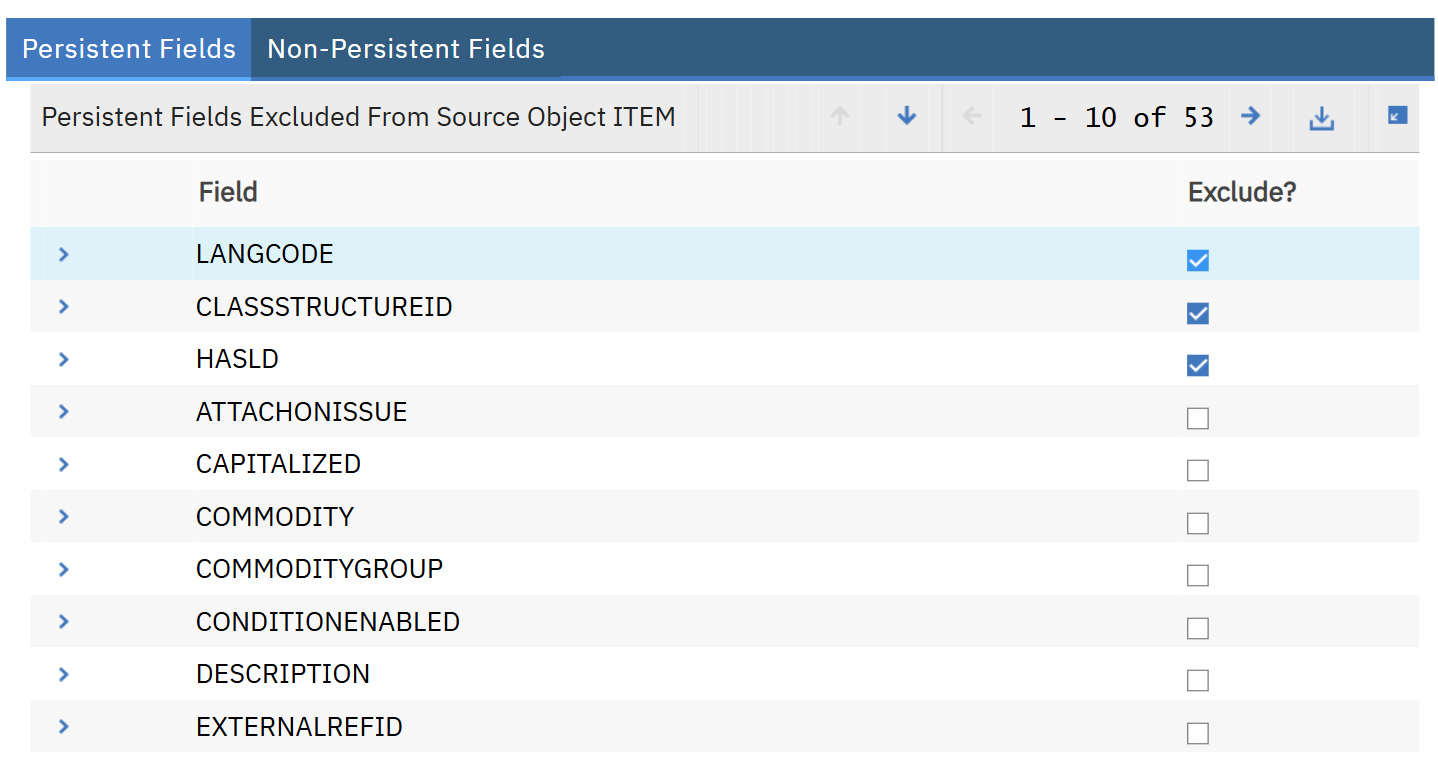

    If in the object structure of MXITEM, got to select action > Exclude/Include Fields. If Description field has a checkbox on it, then Description data will not be returned (because you've excluded that field).
    sun kim
  • 5.  RE: ITEM Description returns empty
    Posted 08-26-2025 18:41
    Thank you @sun kim.  I looked and it is not checked already.

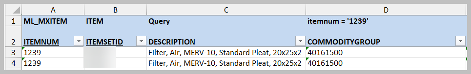

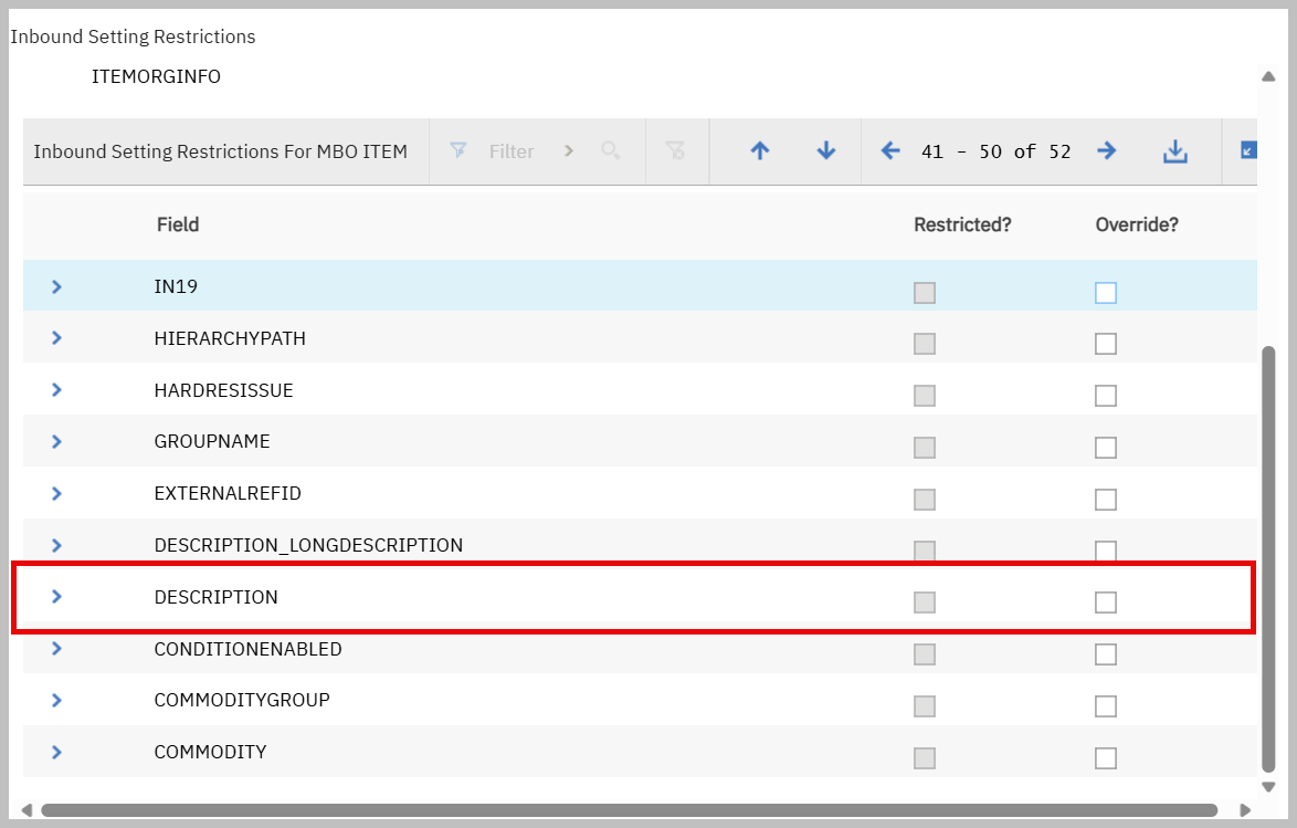

    Below are screenshots of my object structure, from which I can return an item description.
    Under Inbound Setting Restrictions, ensure that the Description is not restricted.
    Below are the results from my MxLoader.
