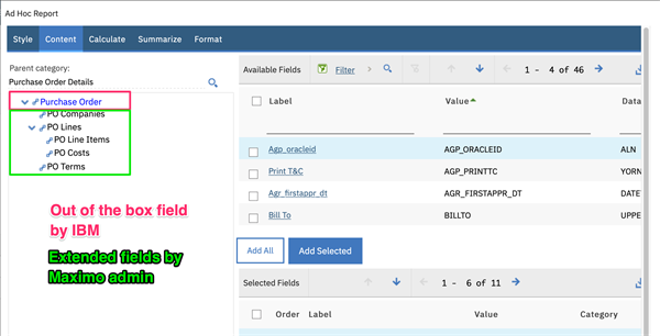

    Do you know if your Maximo administrator has take any steps to expand the fields you can select in a QBR/Ad-Hoc Purchasing report? Out of the box, Maximo will just have a single report option for main Purchase Order (PO table) fields. A common task by either a Maximo admin or Report Developer would be to extend the report structure to other fields.
    (I can't upload an image for some reason to show an example of an updated report structure)

  • 5.  RE: Back Order Reports
    Posted 02-23-2022 11:24
    Hi Gina,
    Here's an example of the extended report object I have in our Maximo environment. The pink box is the main PO table and is what IBM provides out of the box. The additional tables in the green box are what I've extended for options in our Ad-Hoc/QBR reporting.

  • 9.  RE: Back Order Reports
    Posted 03-04-2022 19:11
    There is a relationship from PO to POLINE called "COMPPOLINE" that only returns PO Lines whose RECEIPTSCOMPLETE field is unflagged. To use the ad-hoc reporting capability with Maximo, you'll need to build an Object Structure that utilizes this relationship to the POLINE table from PO. Then you can create ad-hoc queries that show only PO Lines that are not fully received.
    Alternatively you can create the same logic in a custom BIRT report.
    Hope this helps,
    Alex Walter
    A3J Group, LLC
