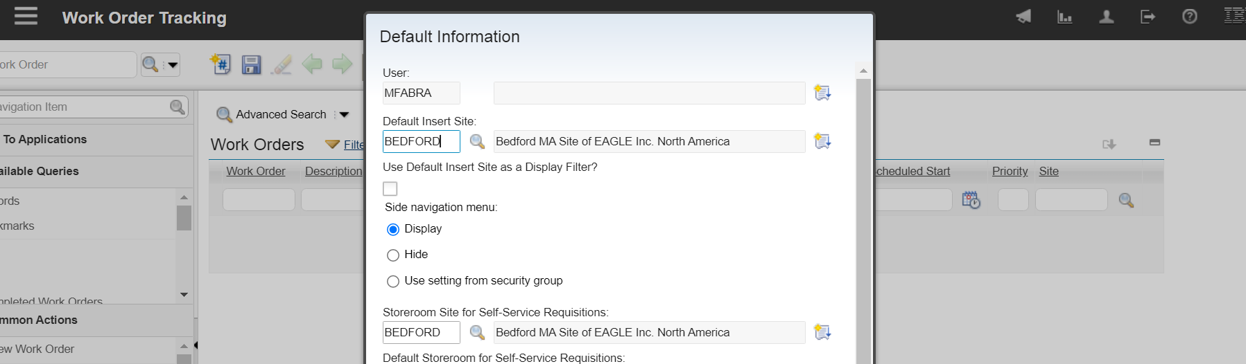

    Posted 08-16-2024 16:09
    Hi @Danny Richardson!
    As you will see in the image below, it is not possible to define more than a single default site. In reality, the default value for anything is always a single value.

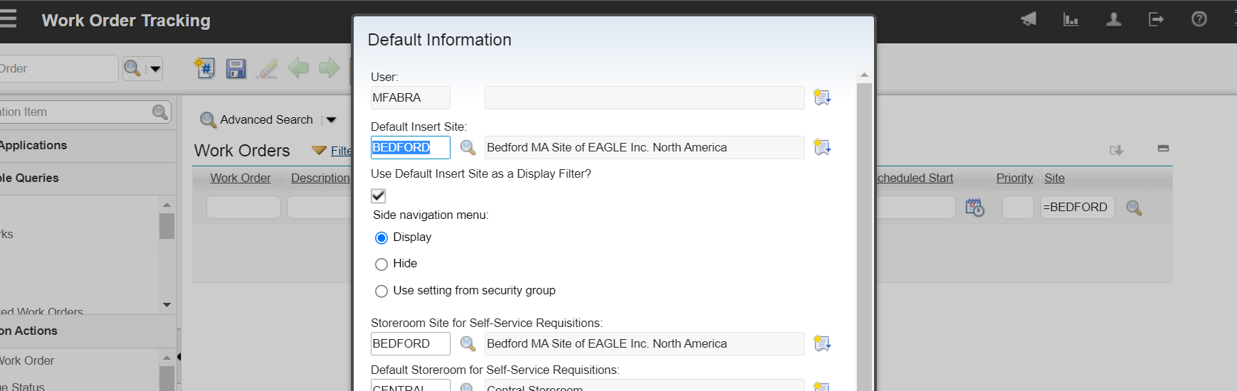

    Then, you will see that below there is a check that says "Use default insert site as a Display filter".
    What this does is, when you enter an application that uses SITE, it defines the search value or it does not define it. Without defining this check, it will search all records for all sites where the user has access (in the case of the defined user, this will be BEDFORD and NASHUA).

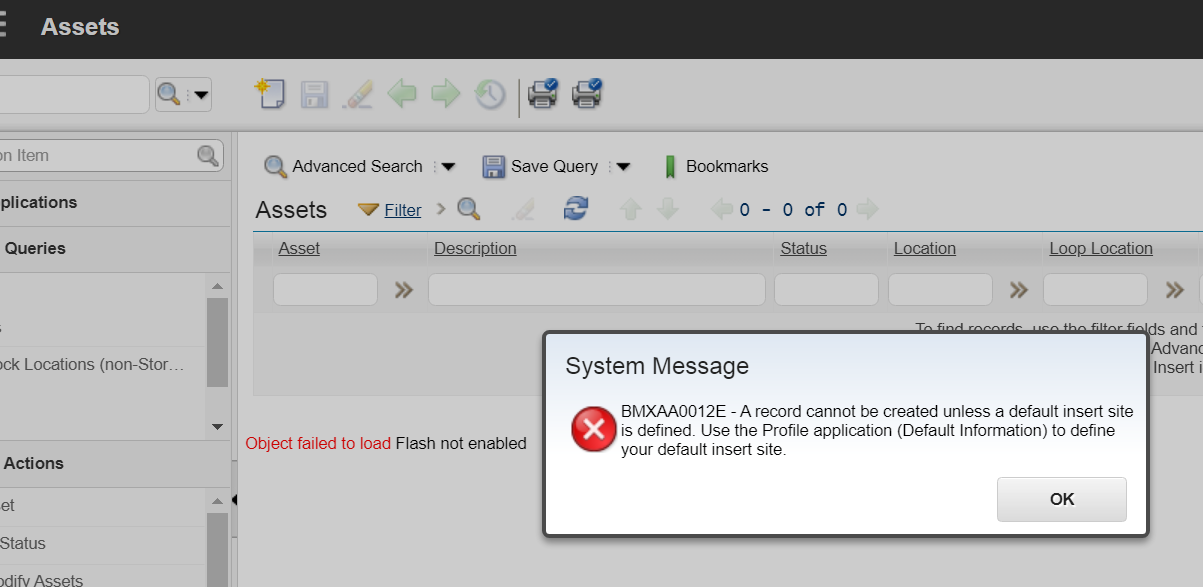

    You can, if you want, try not defining a default insert site that will do what you are looking for, but you may have problems in Maximo and get the message "A record cannot be created unless a default insert site is defined." such as when trying to create an asset. I don't recommend it.
