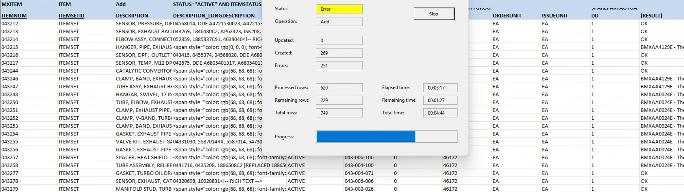

    Hi all,
    I've run into an interesting issue using MxLoader v8.4. I get the subject error but I think it's incorrect because I'm able to load records in the same go. Ultimately, I just keep re-running the load until all records have loaded.
    Please see the below screenshot.
    Matt McGuire
    Aquitas Solutions
    https://www.aquitas-solutions.com/

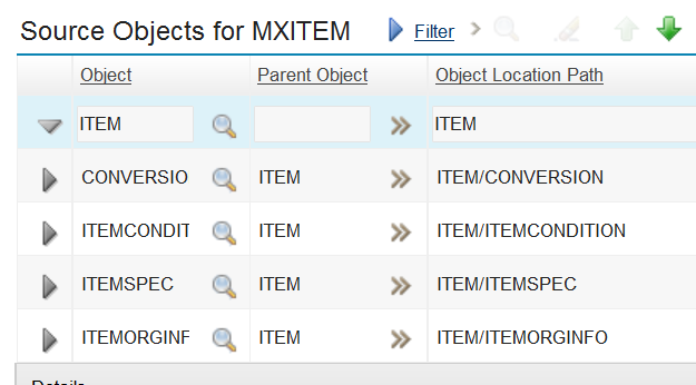

    Hi @Matt McGuire
    The MXITEM estructure is:
    Maybe the error is about ITEMORGINFO or some associated table (conversions, conditions, itemspec). Review the Item/organization data in the item master application in the (ITEM / Organizations Details) option to verify that every data has been imported correctly.

    Thanks Martin,
    I'm not sure there's much to look at in the object structure because when I re-run the load, the records load as expected.
    Matt McGuire
    Aquitas Solutions
