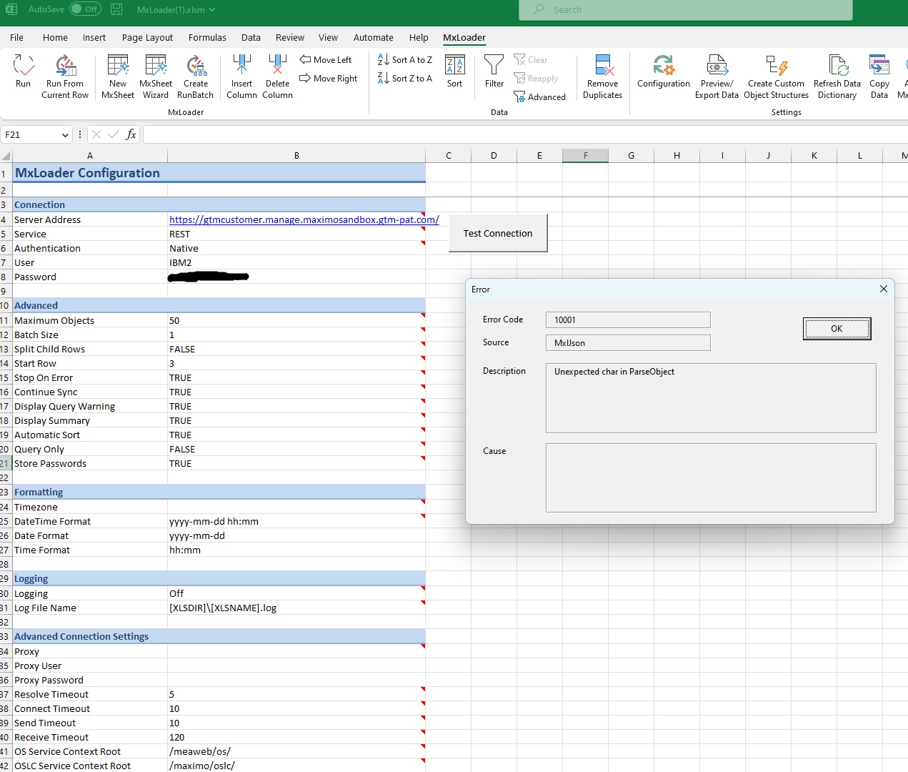

    I'm trying to connect mxloader to MAS (Manage) but I'm getting the error in the image below.
    Signed up for the trial and supplied the URL connection, user/pass parameters to mxloader.
    When I click "Test connection" it throws this error. I'm using the latest mxloader 8.3.6.
    Can someone help out?

    Hi Mate,
    can you check whether you can use apikey instead of the password for mxloader authentication.
    check the below url
    https://bportaluri.com/2021/10/api-key-authentication-mxloader.html

    Hi.
    In the trial I don't have access to Admin panel. Tried to poke around with the HTTP requests but no luck.
    With 7.6.1 preview site, mxloader was able to grab the API Key from the server response, so I assume it get's passed after the login is correct.
    On a browser, how could I access it?
