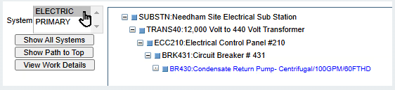

    Look back to that Naviam article that Allan linked to above.  In it, it has this example:
    When I look at that, my initial reaction is, "Why would you have something like TRANS40 as a Location?  That's an Asset!  And what are you going to do if, say, you updated your electrical grid and that transformer changes, like it's not 12000V to 440V anymore?"
    I suspect what's going on there is that while the Location SUBSTN seems like an actual, physical place, the Locations like TRANS40, ECC210, BRK431, and BR430 are more like logical placeholders for Assets.  So you'd have an Asset record for the 12000V--440V Transformer, with its serial number, etc., and you'd assign it to Location = TRANS40.
    The downside to that is if I go to look at all the Assets in a physical Location, such as SUBSTN in this example, I wouldn't (directly) see it there.
    I really wish that Assets had Systems the way Locations do.  It seems more logical to me that you'd want to get to a physical place (Location), observe the Assets there (electrical panel, transformer, pump, motor, etc.), and understand why those Assets are there (e.g. the electrical panel and transformer are part of the ELECTRICAL system, the fire pump is part of the SPRINKLER system, etc.).
    Alternatively, Assets do have the ability to create custom RELATIONSHIPS -- and this is a relatively new feature, I think introduced in 7.6.x. I haven't done this yet IRL, so maybe this is a dumb example, but maybe I'd have a flow switch on the 4th floor mechanical room (Location = AD4MECH, and the flow switch is an Asset in that Location), a custom relationship called ACTIVATES, and connect my two Assets as
    the flow switch Asset (which is in Location=AD4MECH)   ACTIVATES    the fire pump (which is in Location=AD1FIREPUMP).
    This is done in the Assets application, Relationship tab.  In this way, it's at least kind of like creating Asset Systems.  I think this is going to end up being a better approach than the one in the picture above, at least for my use case.  Would love to hear others' input and advice!
