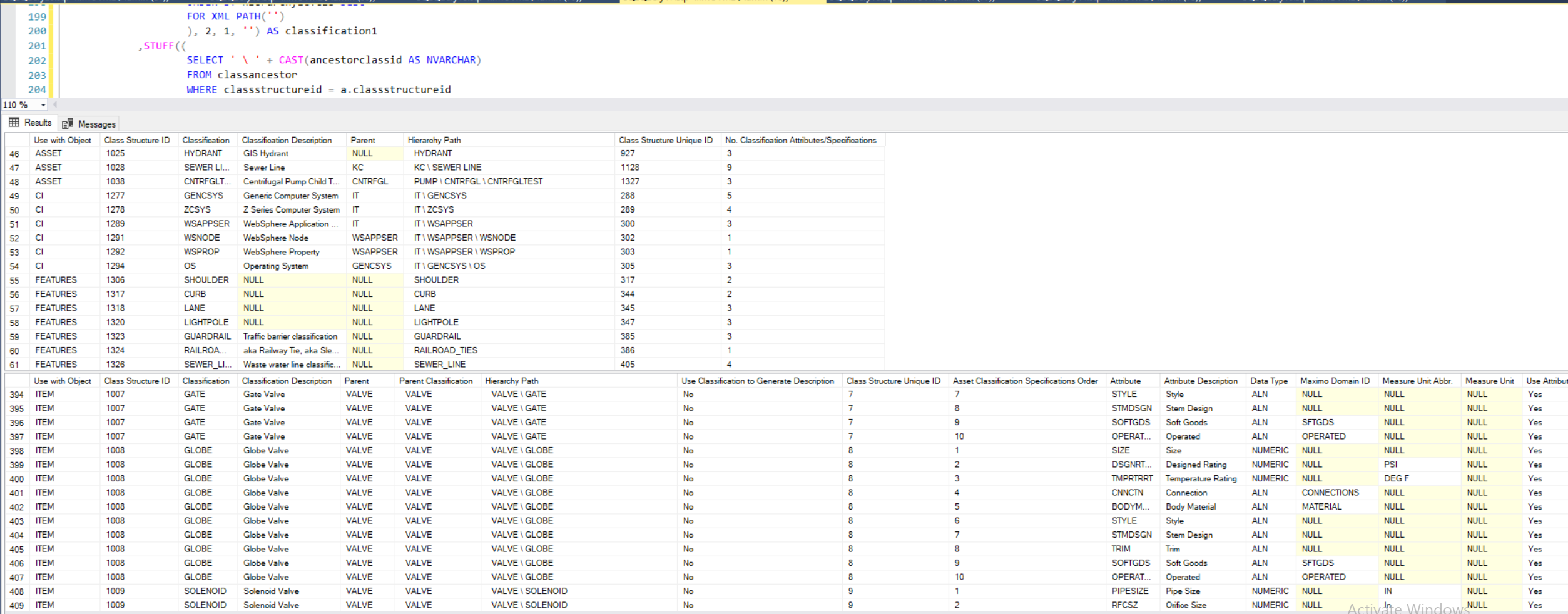

    The classification hierarchy and specification configuration can be rebuilt from the persistent Maximo asset catalog and classification tables. Please see the attached queries, validated in SQL Server and Oracle databases, but need validation in DB2.
    It is possible to further drill down into Maximo Objects to further validate data at the Object level. Let me know if you have any questions; I've used the logic extensively over the past eight years in DB2, Oracle, and SQL Server databases.

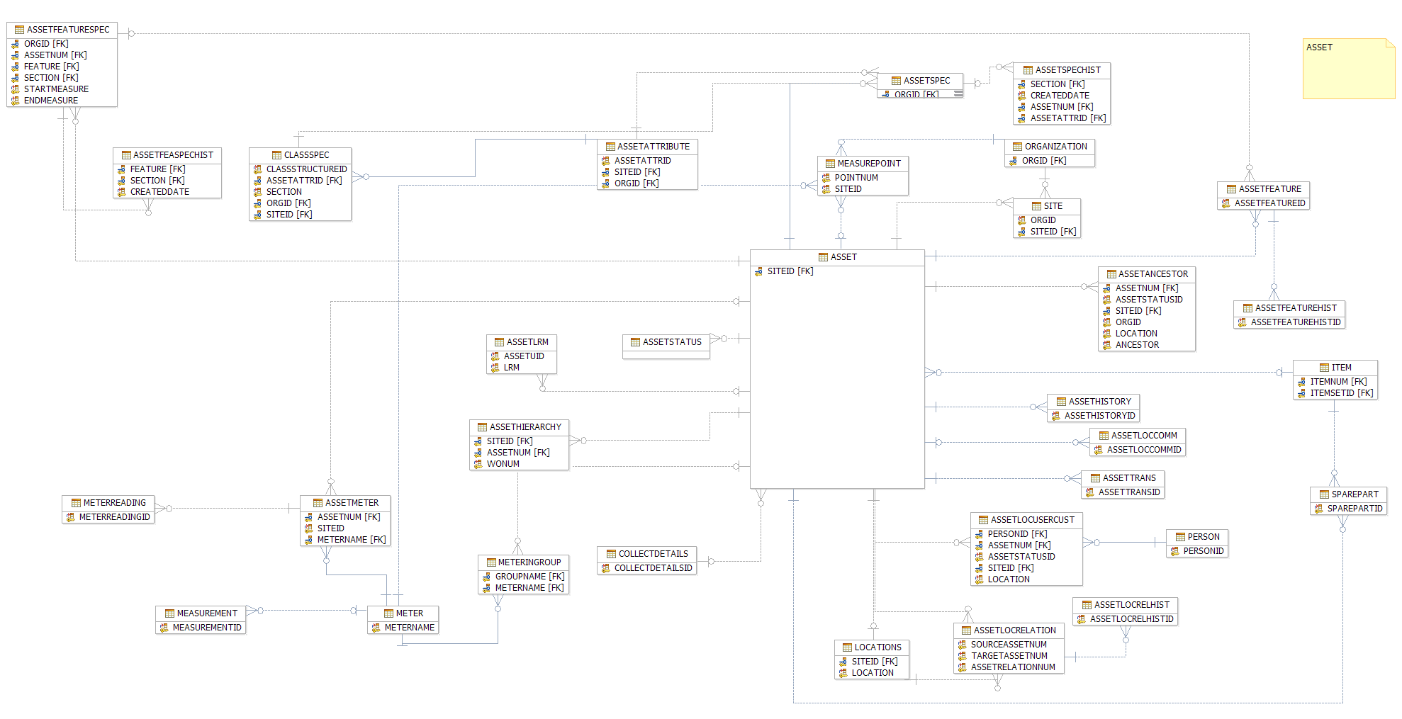

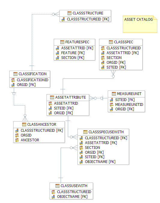

    ASSET CATALOG ERD:

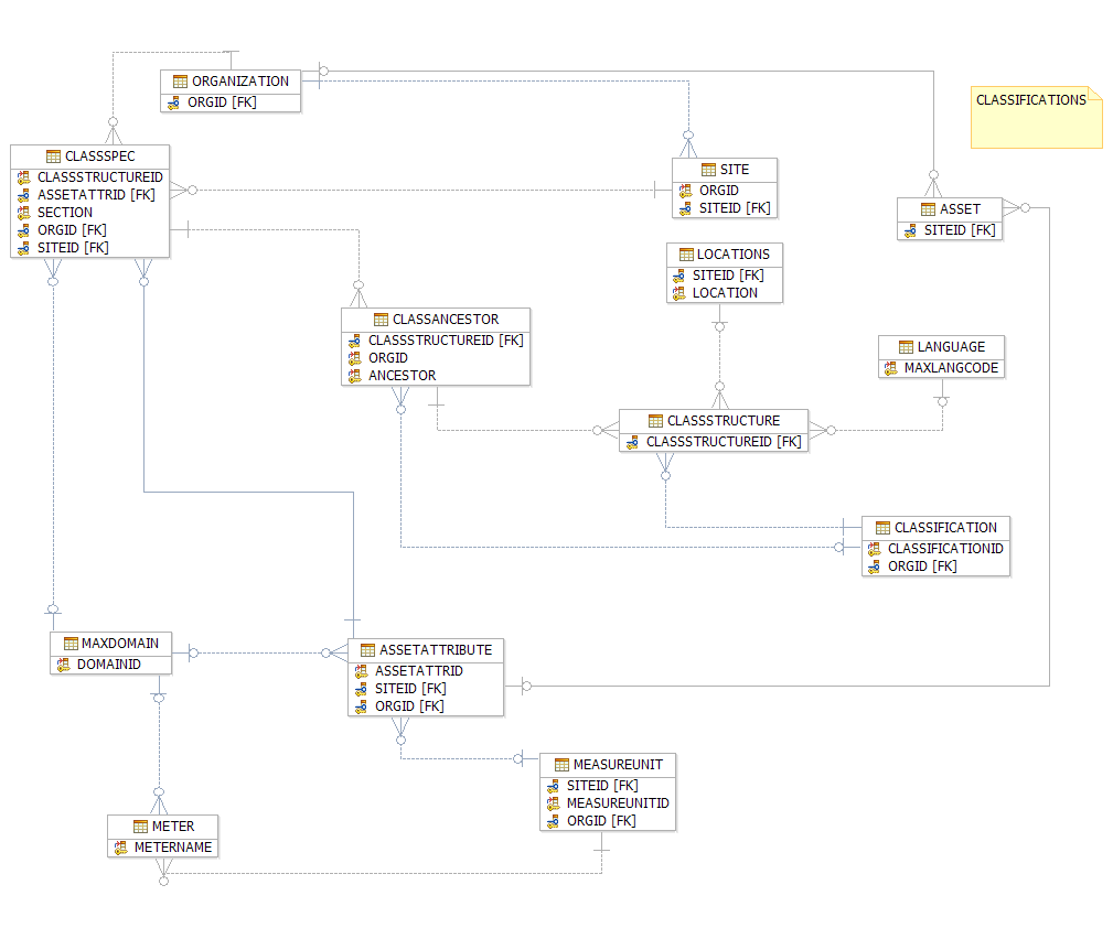

    CLASSIFICATIONS ERD:
    SQL SERVER QUERY EXAMPLE:
    Query Extendability ERD Reference: The Classification Tables below are a visualization of the expandability of the attached queries for the Asset ERD
