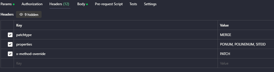

    Hi team, I have a scenario where i need to process receipt inbound to Maximo through REST API and i am currently using a custom Object Structure with inbound processing class same as OOB MXRECEIPT. Since MXRECEIPT is Non-Persistent Object, Response body sent is empty and only Response Code-200 is being sent to middleware. My requirement is to send the response body with attributes like PONUM, POLINENUM, SITEID. Any suggestion or leads on how to modify the response body sent from Maximo would be appreciated.

    Did you try passing the properties in the header with the attributes you want in the response?

    I have tried with passing the properties in header with required attributes, still got no attributes in response body.
