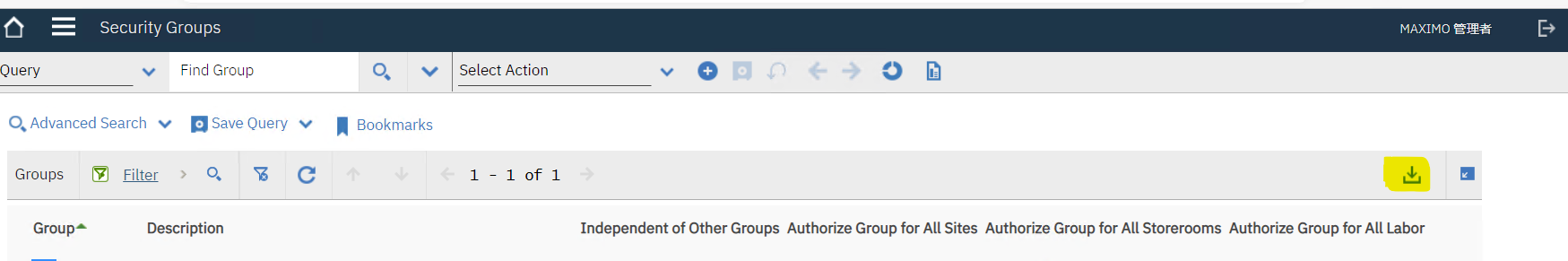

  • 1.  How to disiable download button in table?
    Posted 05-22-2025 10:15
    Can I disable below download button for specific users?
    If I use "webclient.maxdownloadrows" system property, it will be effective for every user. I am looking for something like attaching Sigoption to the download button, but I couldn't locate it in XMLs.
    Thank you in advance!

    Hi Aditi,
    It is not enabled to configure via application designer.
    The 'table download' feature is defined at tabledownload.jsp in 'maximouiweb\webclient\common'.
    Modifying this would be a heavy customization.
    Thanks!

    Hello Aditi!
    This can be done on a global level using CSS customization.  If you add the following lines to any existing CSS customization (from the Admin screen > Configuration > User Interface Customization), the download button will be removed from all tables:
    /* add the selector [title="Download"] into the not pseudo-class */
    .hbsh a:not(.addNewRowbtn, [title="Download"]) {
        display: flex !important
    /* specify that any links with title = "Download" should NOT be displayed */
    .hbsh a[title="Download"] {
        display: none !important;
    Jade Warren

    Thank you for your response @Sankar Ganesh V S and @Jade Warren.
    I get the conclusion that removal of download button is not possible for a specific user. Though it can be removed from all the tables from front end customization.
    That helps. Thanks again!
