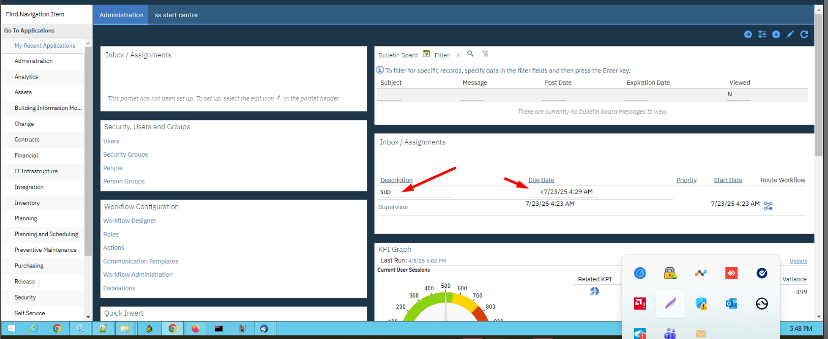

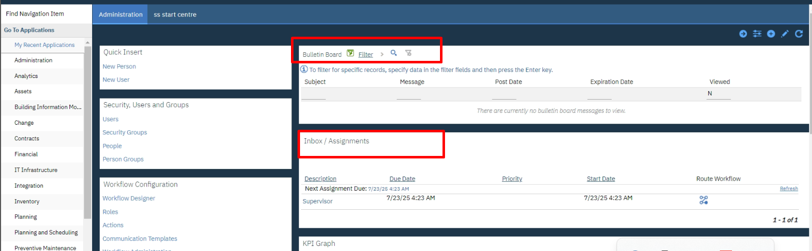

    Hello Experts,
    I have a requirement to enable or create a filter option in the Inbox/Assignment portlet in Start Center. I would like to have a filter similar to what is available in the Result Set or Bulletin Board portlets.

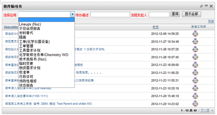

    In my previous company, this functionality was configured as shown in the screenshot below. I would like to know how to configure the same behavior, or alternatively implement a filter similar to the out-of-the-box Bulletin Board filter functionality.
    Filter option in Inbox/Assignment portlet in my previous company:
    Could you please guide me on how this can be configured in Maximo?
    Venkat

  • 2.  RE: How to enable or create filter option in Inbox / Assignment portlet in Start Centers
    Posted 03-16-2026 09:02
    This is a bigger item because you would need to modify the start center portlet code. It's not impossible as you've shown but is not a supported configuration option. And you'd need to maintain this configuration across versions of Maximo.
    For what it's worth, the new Operational Dashboard in MAS does support filtering on assignments. Start centers at this point are not actively being enhanced (though for clarity, are still being supported) so it's unlikely you'll see IBM enhance this.
  • 3.  RE: How to enable or create filter option in Inbox / Assignment portlet in Start Centers
    Posted 03-20-2026 06:21
    Thanks @Steven Shull.
    Achieved this with below code added in inboxportlet.jsp with out java code edit.
