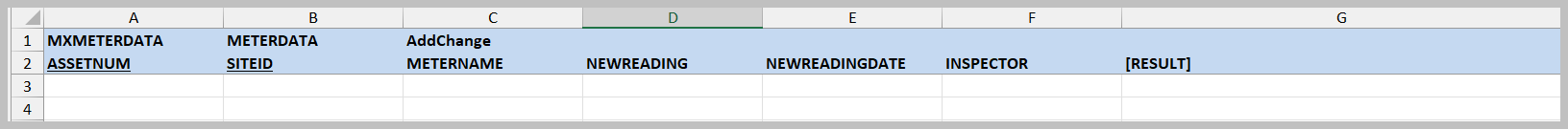

    Have you tried using an MxLoader sheet that looks like the screenshot below? I was able to successfully load by inputting an Inspector ID
