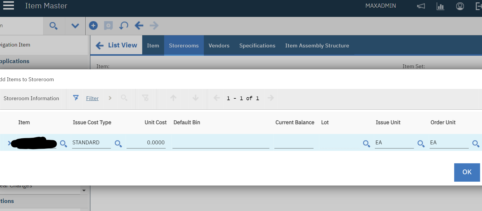

    Thank you, @Adam Ames.  That is the sheet that I needed.  I need to input the remaining information on this screen:
    I tried adding those fields in the sheet, but when I queried our current items, it returned blank.
    Is it possible to add this other information as well?
    • UNITCOST
    • BINNUM
    • CURBAL
  • 4.  RE: Is it possible to add an item from Item Master to a specific storeroom?
    Posted 02-23-2024 15:41
    You should probably just use the wizard to select the fields in MXLoader: MXLoader Wizard url
    Christopher Winston
    Projetech Inc.
    IBM Champion 2024
  • 5.  RE: Is it possible to add an item from Item Master to a specific storeroom?
    Posted 02-26-2024 16:39
    Hi Danny,
    On the Inventory sheet, we will add invvendor.xxxxxx where xxxx is an invvendor field we want to add like lastcost. Then we use the invbalances MxLoader sheet to upload balances if needed.
    Adam Ames
    Kwik Trip, Inc.
