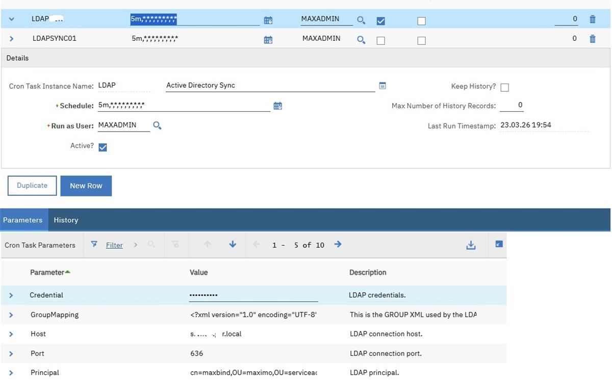

    System Configuration > Platform Configuration > Cron Task Setup
    This parameter should 9th option. Change from port 3268 to 3269.

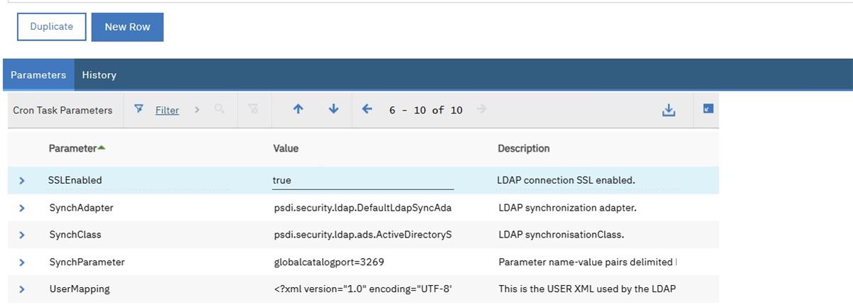

    To resolve this problem, the following attributes need to be set to the correct values in the Cron Task Cron Task Setup Application for LDAPSYNC task:
    Port -- 636
    SSLEnabled -- true
    SynchParmater -- globalcatalogport=3269
    After making the above changes, you will need to reload the cron task and review the systemout.log to confirm the error is not seen.
    Following are the combination for the Port and globalcatalogport settings:
    If using SSL:
    SSLEnabled: true (not 1)
    Port: 636
    Catalog Port :3269
    If Not using SSL:
    SSLEnabled: False (not 0)
    Port: 389
    Catalog Port: 3268

    Sun Kim, good afternoon!
    Thank you for your time!
    I attached two screenshots to my previous message; I even went to look at them again.
    I have everything as you described: ports 636 and 3269. I dug deeper into the logs, and as far as I can tell, Maximo doesn't trust the AD server certificate since it's located within the local network and is itself an internal CA.
    I don't know what to do about this yet, and I don't understand why IBM Websphere isn't having any problems?
