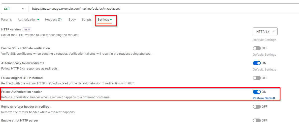

  • 7.  RE: MAS Authentication using postman
    Posted 02-28-2025 06:13
    On postman you can authenticate using a username and password by enabling this setting Follow Authorization header in the "Settings" of the request
    This helps to Retain authorization header (user/password) when a redirect happens to a different hostname (authentication url).

  • 9.  RE: MAS Authentication using postman
    Posted 02-28-2025 09:23
    I did it with this url for example https://<mas manage url>/maximo/oslc/os/mxapiasset and Basic auth header
    Basically,
    • when the Follow Authorization header setting param is disabled (which is the default setting)
      Maximo does redirection to the mas core authentication service without the authorization header -> the MAs core authentication service redirect us to the login page.
    • when the Follow Authorization header setting param is enabled
      the manage endpoint does the redirection to the mas core authentication with the authorization header -> the service generates some cookies and redirect back to the manage endpoint who uses these cookies to authenticate and send the response back.
    you can make the experience and track the traffic in the postman console to see what happens
    Achref Ghezil

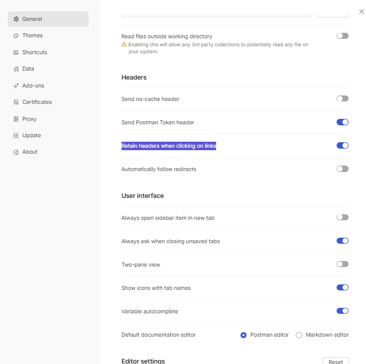

  • 10.  RE: MAS Authentication using postman
    Posted 03-03-2025 15:14
    Thanks for the response. Is it possible to include a screenshot of this settings.
    I cannot find it in postman documentation. The closest thing I found is
    Retain headers when clicking on links
    Thanks.
    Rana Ahmed

  • 11.  RE: MAS Authentication using postman
    Posted 03-04-2025 08:36
    Hi Rana
    here is a screenshot
    Achref Ghezil
