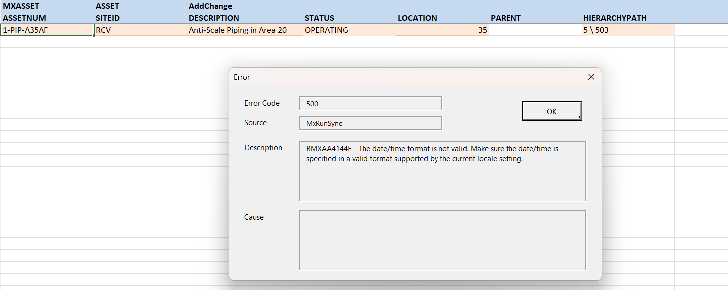

    Good Morning Guys,
    I have a problem with loading the assets with their classifications using MXLOADER. Every time I try to import the data with the HIERARCHYPATH, it keeps giving me the same error. However, if I change the HIERARCHYPATH to the parent (for example, change 5 \ 503 to 5), it works properly.
    Can someone help me, please?

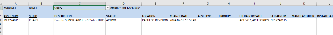

    Hi @Achraf Aouini!
    I try here with a similar sample and I had no any problem sending and updating HIERARCHYPATH.
    You probably have some configuration on that field. For example, we have a development in another application that when a new HIERARCHYPATH is associated, it reads the route and pastes it into another field in text mode in order to make faster reports. Or it is also possible that that field is being audited. What if it is possible, you need a date. Try adding CHANGEDATE to your mxloader. Send the SYNC with the data manually loaded by you. If it doesn't take it, change it. For example, if you read it like this 2024-07-19 10:58:49 and it doesn't take that format, change it to 7/19/2024 10:58:49 or vice versa (this has happened to me). Also, check the configuration date format of your MxLoader because modifying it may fix it.
    Check the entire asset table to see if there are any fields that it is asking you for when you load HIERARCHYPATH.
    Also, don't forget that if the asset has an item associated with it, the HIERARCHYPATH of the asset should be the same as that of the item.

  • 7.  RE: MX LOADER issue
    Posted 07-19-2024 12:20
    @Achraf Aouini here are a couple of suggestions for you to try:
    1. The original error in the screenshot seems to indicate that the Hierarchy Path column might be set in Excel as a Date/Time field. I suggest changing it to General or Text for the entire column. It is likely trying to convert "5 \ 503" to a date format which is not what you want.
    2. Duplicate your worksheet and run a query for a single Asset record, versus Add or Change. Query that record and verify the format of the data. Then make a simple change to the data and flip Query to Change and see if you get the same error.
    Hope this helps.
