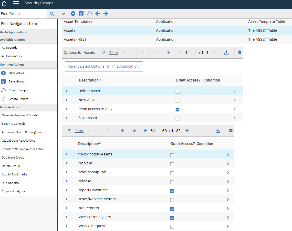

    Hello all,
    I'm looking for a way to quickly analyze what boxes are checked to review a group's security permissions.
    I can't seem to find this option when trying to create a report in Maximo.
    Is it possible to use MX Loader for this?
    Thank you in advance.

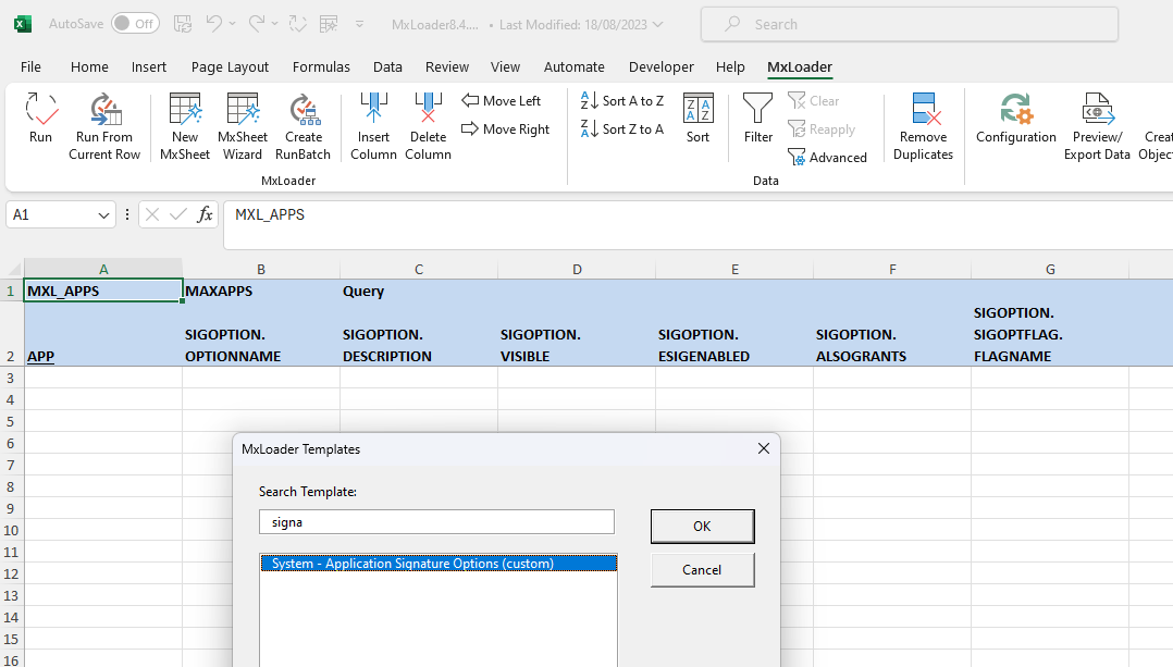

    Posted 02-12-2024 11:25
    Have you tried this template?
    You can also try this very useful report for a quick overview of security setup: https://bportaluri.com/mxdev-maximo-reports/maximo-security-overview-report
    Regards
    Bruno Portaluri (MaximoDev)
