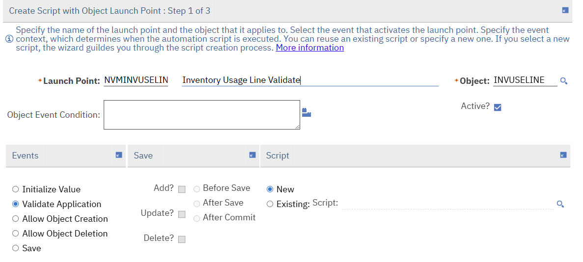

    I would think about creating a permission in the Inventory Usage application because group names will often change. But writing a script that prevents users from issuing a rotating asset in a DEFECTIVE status to a Work Order could be accomplished with an Object Launch Point automation script on INVUSELINE with the Event as Validate Application.
    The script language is jython and the syntax would be something like this:
    profile=mbo.getProfile()
    groupNames=profile.getGroupNames()
    restrictedGroups=["MAXADMIN","TECHNICIAN"]
    if mbo.getString("USETYPE")=="ISSUE" and mbo.getString("WONUM") and mbo.getString("ROTASSETNUM"):
        for group in restrictedGroups:
            if groupNames.contains(group) and mbo.getString("ROTASSET.STATUS")=="DEFECTIVE":
                service.error("nvm","defectAssetToWO")
    The first two lines are used to get the logged in user's security groups. getGroupNames returns a Java HashSet that we later use
    The third line of restrictedGroups is a list of group names that we want to prevent anyone in from being able to issue to a work order if the asset is defective. We later loop through this list to determine if they are in the group.
    Then our first if statement is checking that it's an ISSUE transaction (not a transfer), that a WONUM is referenced, and that a rotating asset is provided. These values will all be in memory and can be returned quickly.
    If that criteria is true, we then check the group names to see if our user is in at least one group that we want to prevent. We do this before checking the asset status because it's also in memory and can be retrieved quickly.
    If the user is in a group that we want to restrict, then we check that the asset status is DEFECTIVE. We do this last because it will initialize a new MBO which is the most expensive logic in the entire script.
    If that is true, then we throw an error. You would configure this message in the Database Configuration application with a user-friendly error message to display to the user.
