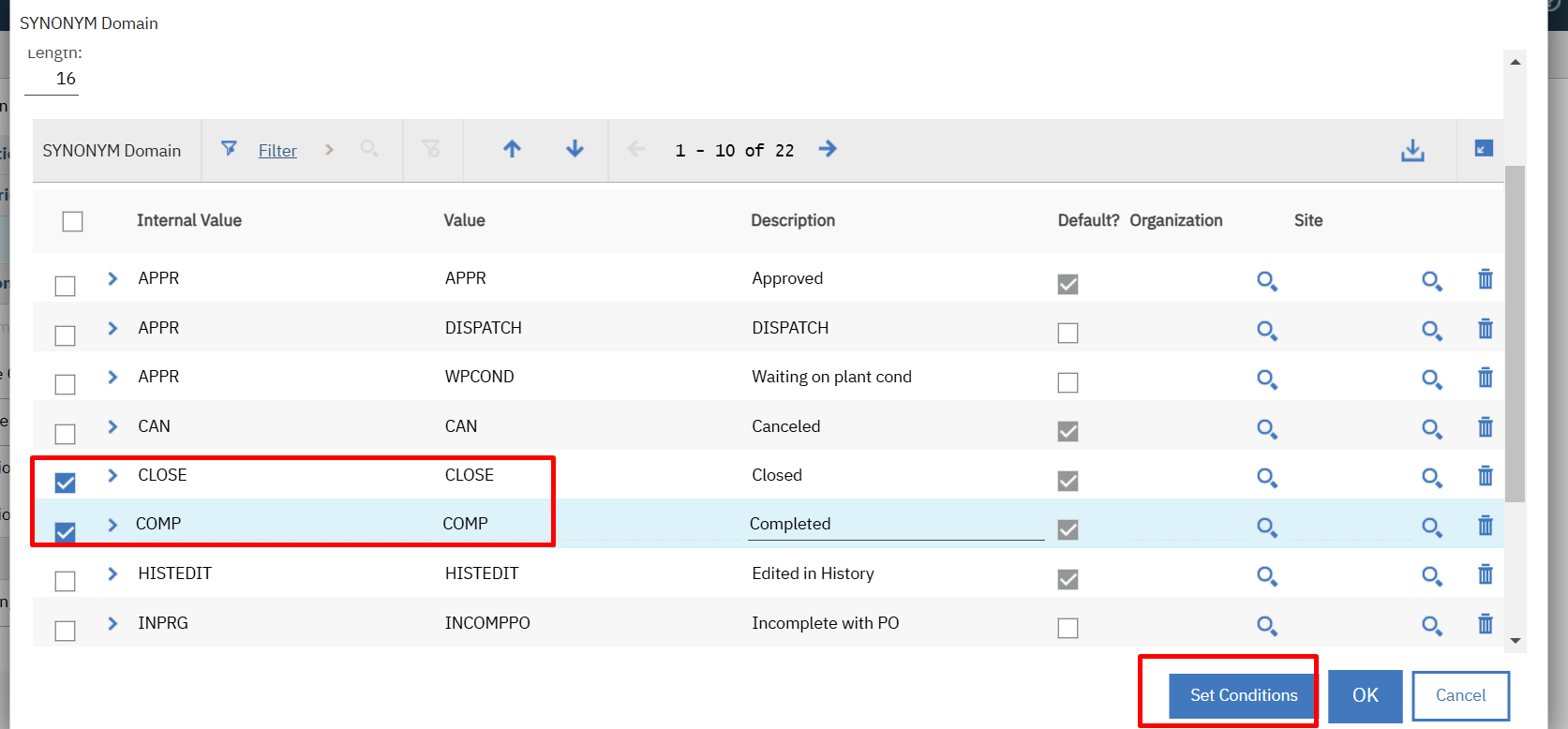

    To achieve the requirement of enabling the "Complete Work Order" and "Close Work Order" actions only when the user is part of the MXOSLABOR security group, the SAP Checkbox (mxosinvsap) is checked, and the status is not 'COMP' or 'CLOSE', follow the steps below:
    Create a new condition with the following expression:
    :user in (select USERID from GROUPUSER where GROUPNAME='MXOSLABOR')
    and :mxosinvsap=1 and :status not in ('COMP','CLOSE')
    Attach Condition to the WOSTATUS Domain for respective value,
    Apply on the security group respective action as well so that that 2 action will automatically gets  read only

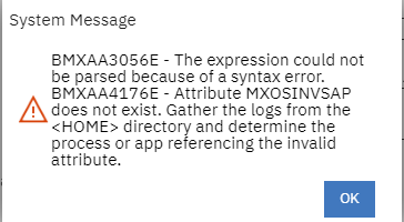

    When applying the following conditional expression in Conditional Expression Manager, I get the error BMXAA4176E - Attribute MXOSINVSAP does not exist, as seen on the image below (while I was logged in as MXOSHEADOFENG so I could create an Work Order to escalate to MXOSLABOR for testing purposes, while trying to APPROVE the Work Order)
    AND EXISTS (SELECT 1 FROM WPITEM WHERE WPITEM.WONUM = :WONUM)
    AND :MXOSINVSAP=0
    AND :STATUS NOT IN ('COMP', 'CLOSE')
    However, MXOSINVSAP does exist in the WORKORDER table and is persistent, as confirmed by:
    • Running SELECT * FROM SYSCAT.COLUMNS WHERE TABNAME = 'WORKORDER' (DB2 confirms its presence).
    • Checking Database Configuration (MXOSINVSAP is listed under WORKORDER).
    I have attempted different syntaxes:
    • Using uppercase (:MXOSINVSAP=0)
    • Removing object reference (WORKORDER. prefix).
    Yet, Maximo still throws an error when validating the condition.
    Any insights or solutions would be greatly appreciated! Thanks!
