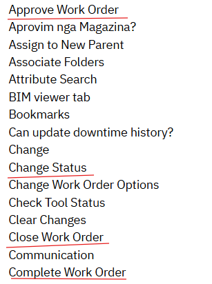

  • 3.  RE: Warehouse Group Cannot Change Work Order Status
    Posted 06-30-2025 06:25
    Hi Michael,
    Thanks for your response. I've already checked everything you mentioned and verified them in the USERS application as seen in the image below, but still no success:

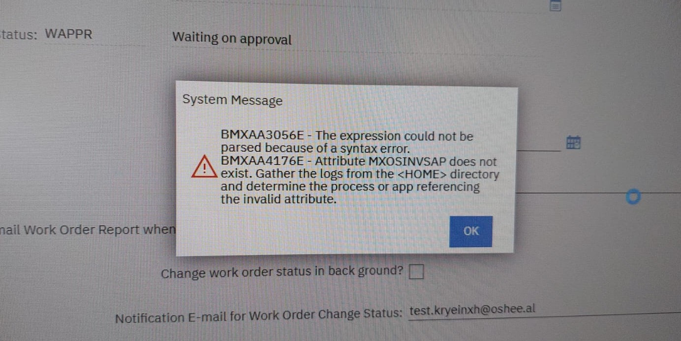

    However, I'm running into a weird issue and I could really use some help.
    We've got a custom checkbox field MXOSINVSAP on the Work Order. The process is: labor adds materials in Plans, then logistics goes in and checks the box to confirm those materials exist in SAP. Only after that can labor declare them in Actuals, and only then should the WO be allowed to go to COMP.
    So we've added a condition to the COMP status to enforce this. It worked fine for a long time, but now, suddenly, we're getting this error on any status change:
    The field exists, it's in the WORKORDER object, it's on the WOTRACK Application Designer, the security group has access, and the condition is only on the COMP status.
    Still, Maximo throws this error no matter what status you change to, even ones that don't hit the condition. Anyone seen this before or know how to force the attribute to load so it stops complaining?

  • 14.  RE: Warehouse Group Cannot Change Work Order Status
    Posted 07-07-2025 09:29
    My experience with using Conditional Expressions to control/influence status changes for Work Orders is:
    You have to write the "same" Expression twice, once for WORKORDER, and once for WOCHANGESTATUS.  But the one for WOCHANGESTATUS has to be tweaked so that it can properly execute against the WORKORDER record you're actually trying to modify.  For a very simple example, I might have two Conditional Expressions, one for WORKORDER:
    :status = 'INPRG'
    and a second one for WOCHANGESTATUS:
    :wostatus = 'INPRG'
    Then I apply both of these to the same Status in the WOSTATUS domain.
    Based on your screenshot, I would guess that the Conditional Expression for WOCHANGESTATUS wasn't properly tweaked.

  • 15.  RE: Warehouse Group Cannot Change Work Order Status
    Posted 07-09-2025 04:32
    Hi Travis,
    I was able to fix this issue by adding the Object Name: Work Order to the Conditional Expression present in the COMP status. Now everything is working fine.
