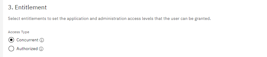

Do you know if you're on 7.6.1.X of Maximo or Maximo Application Suite (MAS)? In MAS, there's a field on the user record that indicates whether they are Authorized or Concurrent (screenshot below). This is accessible on the Users section of the Administration module (which only a subset of your organization would have access to).
If you're on 7.6.1.X, your licensing is likely only Authorized only. We added concurrent but it's only for some license types and most customers had licenses before concurrent licenses became available. Some customers mix and match but most try to use one or the other. There is no enforcement mechanism in 7.6.1.X but there is a License Usage Monitor application to try and help report on your usage.

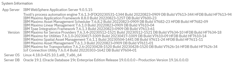

Since you're on 7.6.1.X from a technical perspective (understanding that contractually you're on MAS licensing and taking advantage of the dual entitlement), what I showed you is not available. I assume since you are calculating app points that you have installed the MAS App Point utility in your 7.6.1.X environment. IE you are seeing these point calculations in an application called "AppPoint Licensing Setup".
Assuming that is the case, if you're on the version 2 of the utility, we added a new domain value to the USERTYPE domain with a value of AUTHORIZED. Any users in Maximo that you set the USERTYPE on MAXUSER to AUTHORIZED will be treated as a named user for purposes of this utility.
When you get to MAS, please be aware that this setting will not change how users are pushed from the Manage database into MAS. All users pushed from Manage to MAS will default to CONCURRENT and need to be adjusted in MAS after the upgrade.
