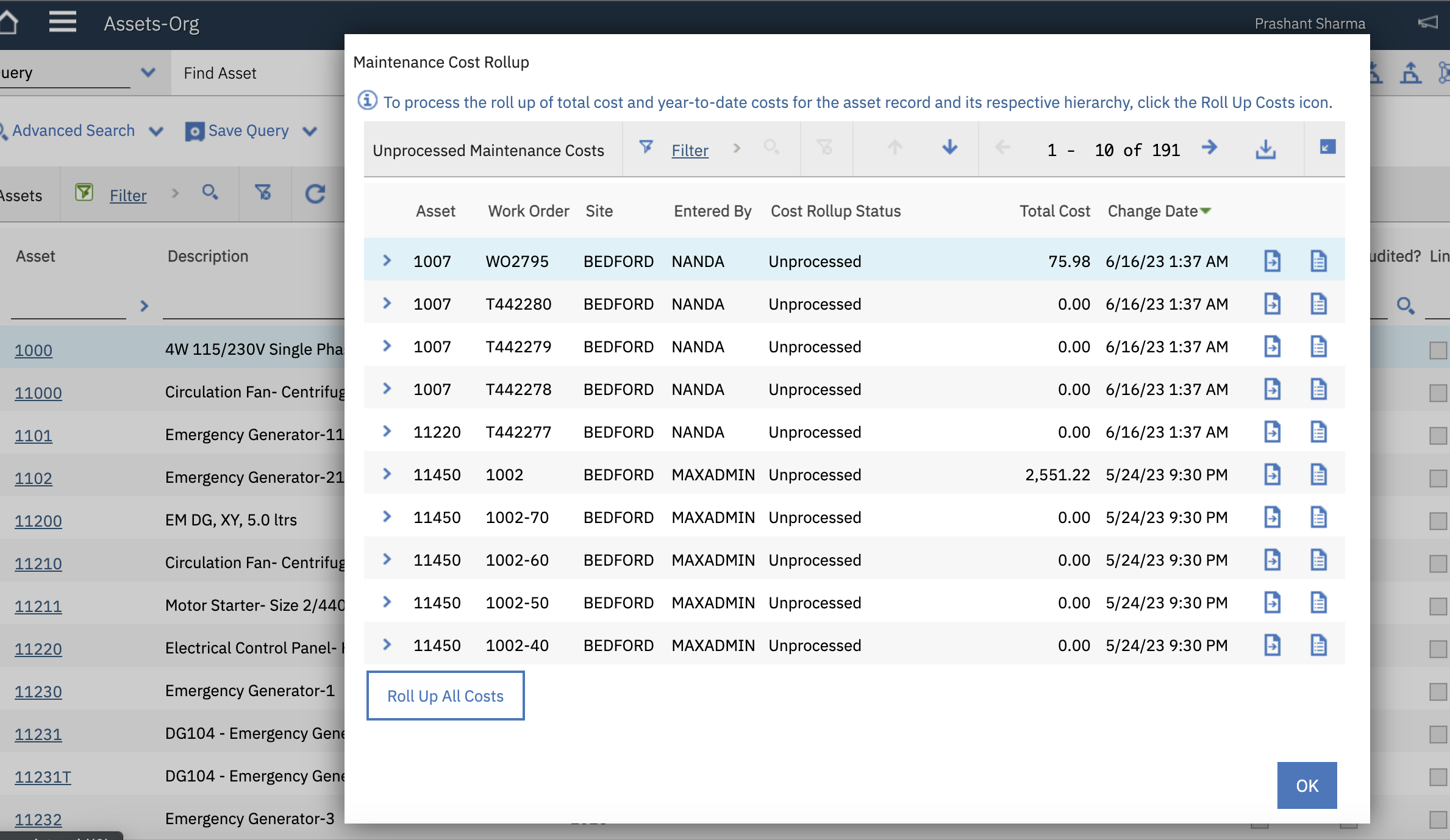

Prashant Sharma
Typically Maximo has a report YTD Maintenance Rollover which does the job to calculating total cost from work orders and update on YTD Cost field for asset.
Now Asset application has select Action - Roll Up Maintenance Cost which does this job in Maximo 7613.
