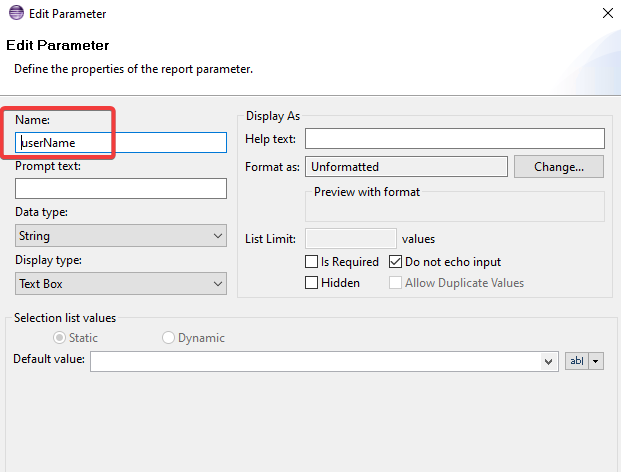

I have a request to write a BIRT report which shows LABTRANS records for the user who is running the report and for a date range which they put in as parameters.
How do I get the user who currently is running the report and use it in the sqlText?
Thanks!
Jan Ondrušek's profile image
Jan Ondrušek  Best Answer
Hi Eric,
you need to add new paremeter into report and use this parametr in SQL query. Check this link: https://www.ibm.com/support/pages/how-add-username-v7-birt-report
Example how to use this parameter in SQL:
+ " LEFT JOIN PERSON ON person.PERSONID = upper('" + params["userName"].value + "') "
Eric Burkland's profile image
Eric Burkland
Thank you @Jan Ondrušek   I tried this initially and it didn't work.  The key piece that I wasn't doing correctly is after importing the report from the Report Administration page you have to delete the userName parameter from the Parameters listed on the page.  If you leave it there it expects a value when the user runs the report and if you run the report anyways without a value it leaves it as null.  I guess reading the document carefully is important :-)
Thanks Again,
Eric
