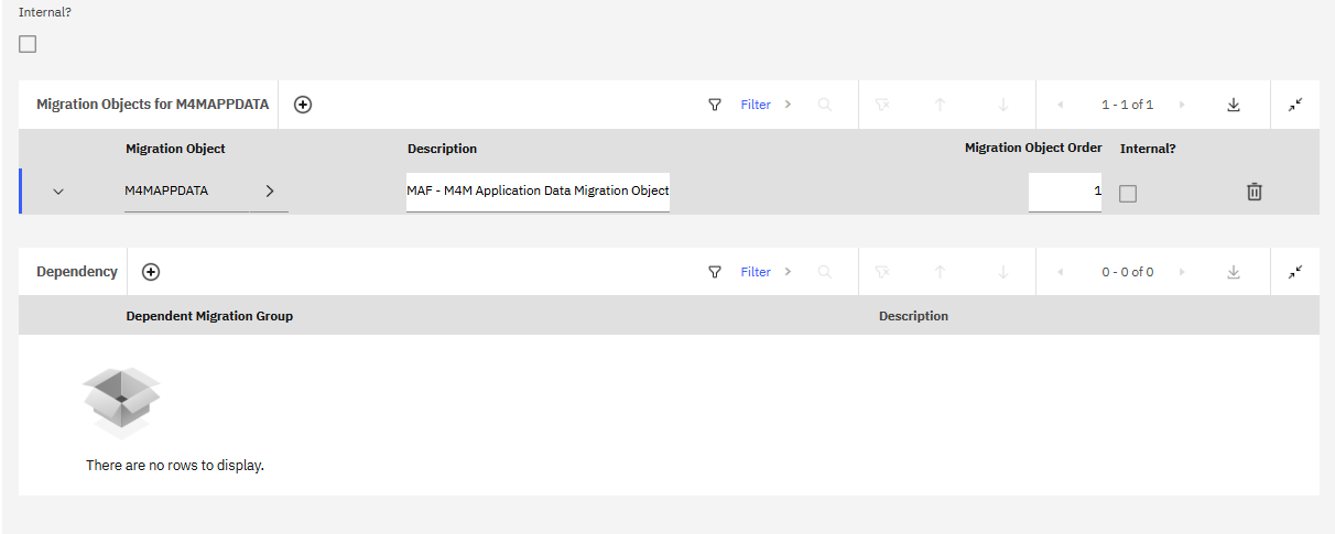

I've created the object structure as well as the migration group in the source environment as outlined above. (Note: I named the OS / MG M4MAPPDATA instead of MAFAPPDATA)

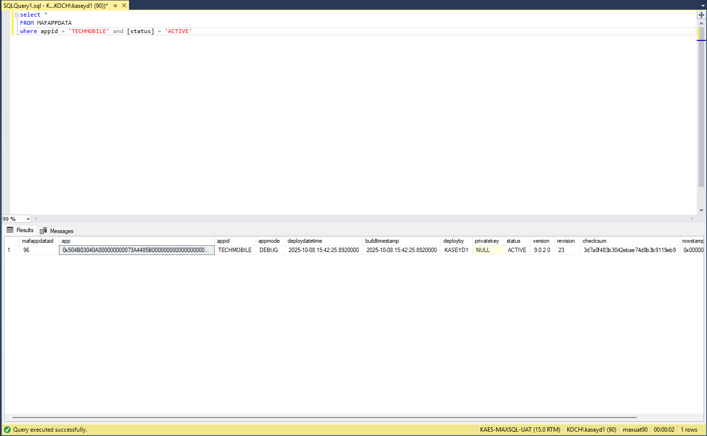

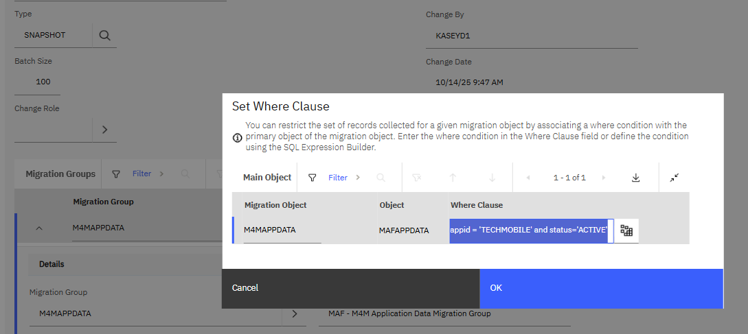

In order to deploy only the most recent version of the TECHMOBILE app, I set the following where clause:
I've confirmed that this where clause should result in only 1 row being returned from the database, and that there are no dependent object structures in the migration group:

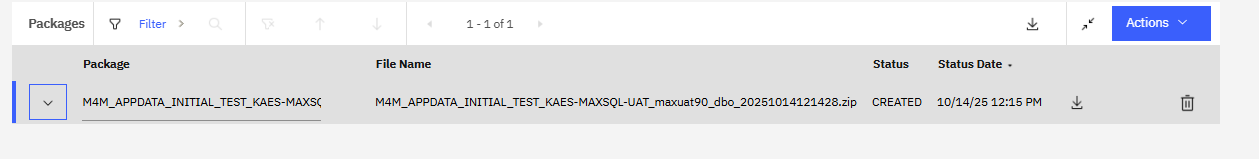

All seemed to be going as intended, as I was able to successfully create and download my initial test package:

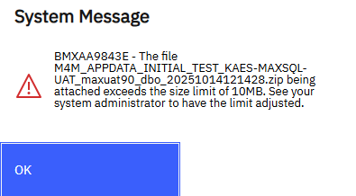

However, upon uploading this package to the other environment, I was met with the following message:

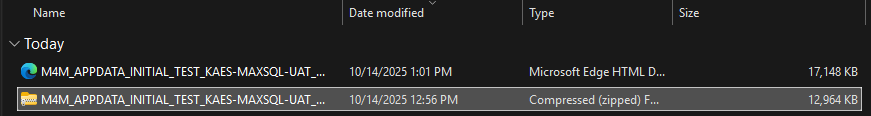

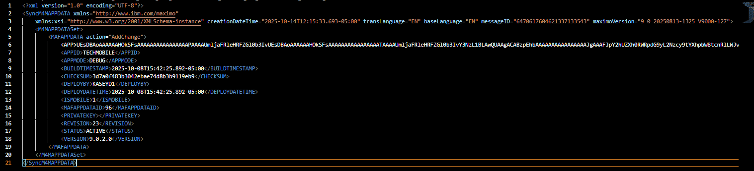

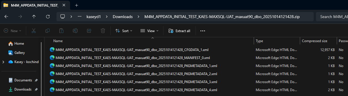

I thought this was odd, as I wouldn't expect the single app to contain more than 10MB of information. However, upon exploring the ZIP file, I see that this is likely the case:

The root cause of the Error you are encountering is that the file you are attempting to upload exceeds the current file size limit of 10 MB. The updated file is 12.964 MB.
Options to resolve the issue:
  1. Option 1 - Property Name: mxe.doclink.maxfilesize from 10 to a size greater than 12.964 MB. Please see the attached step.
