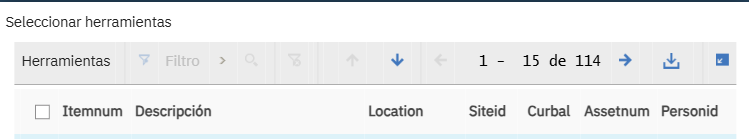

Hi, I have problems with automatization. I created a dialogue in the LIBRARY.xml to show a view of different tables. Here the user can multi-select rows and after this selection is added to the inventory usage application in invuselines. The problem is that the filter field is not working; it only shows as if it has been deactivated (in grey).

In the inventory usage application, the dialogue shows like this (filter field deactivated):
Can please someone tell me if I missed writing something on the code or what is going on?
Note: This same view is used in other dialogues and works properly.
Without more details, my assumption is that the relationship CCNPINVBALCUSTOMTOOLS points to a non-persistent object. Non-persistent objects don't exist in the database and thus can't be filtered. When a user filters in Maximo it executes the search against the database directly. When you filter itemnum=1001 for example, that changes the query to select * from tablename where itemnum='1001';.
