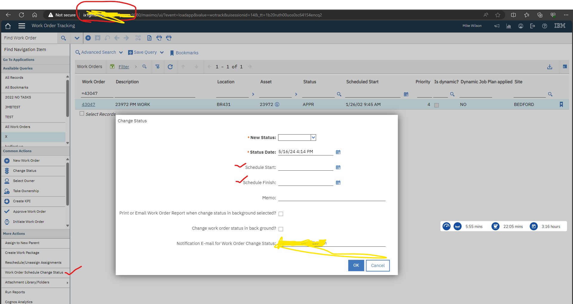

Hello Experts,
I am trying to configure maximo by giving an option on List Wo Status Change Window to set the Schedule Start and Finish Date while scheduling or rescheduling in bulk.
To achieve this i have copied the List WOCHANGESTATUS dialog from library xml and added to wotrack app.xml. Also i have created 2 attributes same as workorder schedule start and finish date for WOCHANGESTATUS non persistent objectBy doing this you can see both the Schedule start and Finish date are appearing but the values are not getting updated for schedule start and finish on workorder application. refr the below screenshot.
Any help is highly appreciated. @Steven Shull @Prashant Sharma   Have you ever come across any such requirements.
Steven Shull  Best Answer
You would need to add logic to copy the values down. This dialog only supports status changes and does it by creating an asynchronous job to change the status or enumerating through the records and performing a change status for each record.
I would personally create this as my own dialog and action to perform the updates to schedstart/schedfinish. Otherwise, you'd need to disable the ability to change in the background or enhance the async job process to support it as well (which would require copying this data down somewhere else for processing purposes).

@Lacey Lurges Thanks for your reply. We are actually trying to set the SCHEDULE date and SCHEDULE finish date to null through bulk action  and if you out a null date on reschedule date and select to reschedule checkbox system throws a system error. You are correct on a way how the functionality works but we are trying to customize the window as per our requirement and give an option to users to do bulk actions with allowing completely removing schedule dates from workorder.

@Steven Shull Thaks for your reply i am able to use a new push button within the same dialog and able to access through auto script by establishing a relationship with WOCHANGESTATUS non persistent object.
