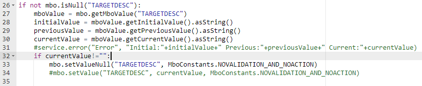

I tried to use automation script to check what the mbo currentvalue is and then tried to stop it being changed again. But it looks like this "Inspection Form Name" override happens later than my automation script launch point and will not be stopped.
My automation script has attribute launch point for MULTIASSETLOCCI.TARGETDESC as below:
Automation Script is as below:

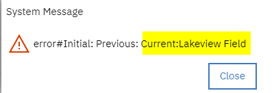

The script will get launched every time I generate work order from the PM with the Route. And with Line #31 not being commented out I can see that initialValue and previousValue are both null, but currentValue is the correct value we want to cross over from "Route Stop Description" by our previously created cross over domain database configuration):
However, with Line #33 or #34, it will not stop the Inspection Form name to override the currentValue we want "Target Description" to finally hold.

  1. if commenting out both script line #33 and #34, the work order result will show the values we want in Target Description:
  2. if commenting out only Line #34, the work order result will set Target Description as Null:
But if we give inspection form to the route stops, it looks like after my automation script launches, the "Inspection Form Name" value will still override to "Target Description" at some point which I don't know when and how to stop it.
