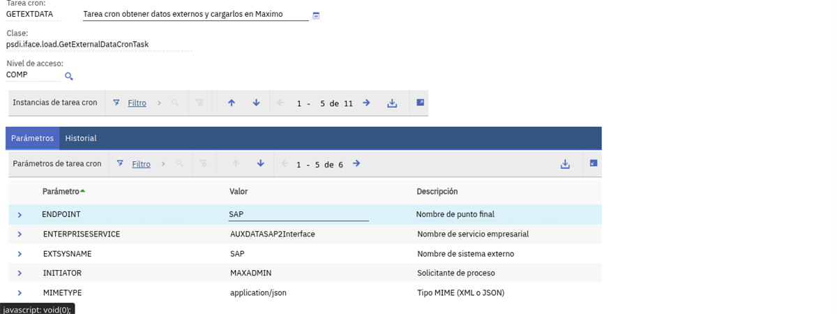

Hi Jose, I've created a crontask using the class psdi.iface.load.GetExternalDataCronTask, and then I've scheduled a crontask instance which works fine but after run it's marked as inactive whitout errors on log files, so I have manually check it as active for running.
Cron task configuration for integration
I hope this helps.
