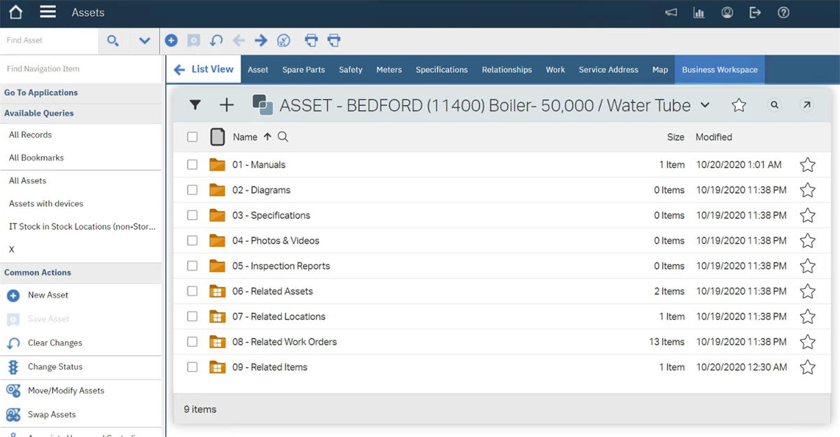

Hi I'm trying to achieve on Asset application a way to add a new tab which contains all attachments related to selected asset in the way that is shown in the image. I've tried extending TreeControlBean but whitout success. In fact the configured tree is not visible, evenmore, debuging the extended class on Eclipse I can see that it's containing the right Mbo.

New tab in Asset application showing attachments

HI, I've expressed wrong, What I really looking for is some type of documentation on how to use Tree control. I was studying the SecurityProfileTreeBean class from user application but I couldn't achieve its work. The only source that I have is the Java API docs, but its documentation isn't enough and some cases unclear.
