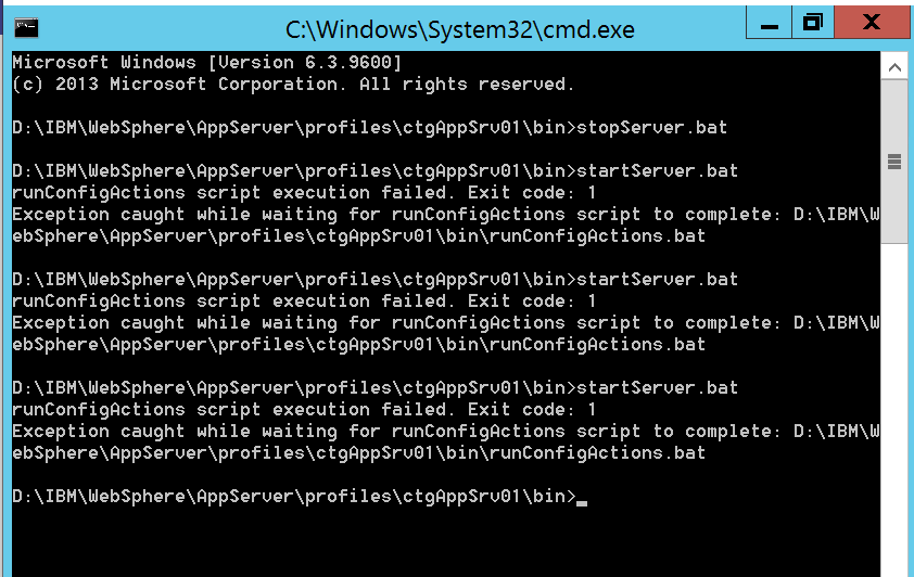

1.When i run the update statements above and tried to turn on Admin mode from front end(It failed).
2.Stopped the server from the websphere console ( It failed -it read Failure to invoke Request Filters)
3.Forcibly stopped the Server from Services.msc
V8.5 cellmanager01---stop
V8.5 node01 -stop
4.Tried to Start Server it failed again
Note :
1.command Prompt : Running through Run As Admin.
2.MARXVARS table VARNAME='ADMINRESTART' and 'CONFIGURING' set to OFF and 0 .
