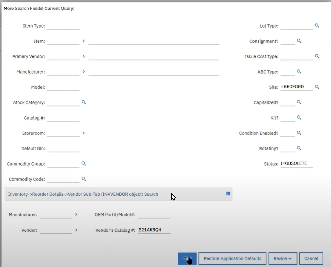

Christopher Winston's profile image
Christopher Winston
You may also want to extend advanced search to look through the invvendor record:
There is a video that runs about 6 minutes to provide more detail.

Anna Max's profile image
Anna Max
Thanks a lot, @Christopher Winston, I watched the video and got some useful ideas from it, however, this approach also needs some customization but if this facilitates tracking the OEM and managing inventory then I will try it definitely.
