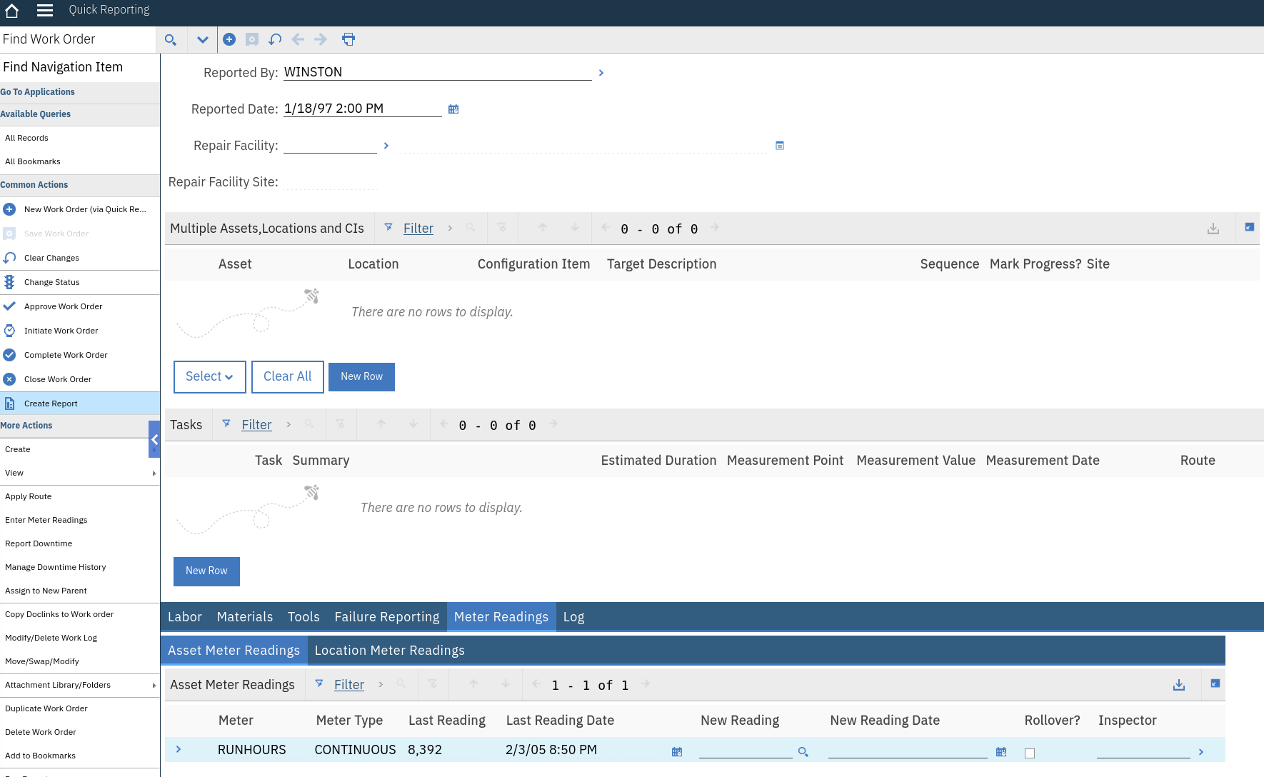

@Sean Clark-McCarthy  So if I don't want the user to record a new meter reading, I only want the system to pull the current meter reading from the Asset and display it on the Work Order, do you know how I can do that?  Because my meters currently update every 24hrs from a computer system.
Sean Clark-McCarthy's profile image
Sean Clark-McCarthy
@Danny Richardson -- Ahhh - I misread your original statement - you just want users to "see" the readings available, apologies.
That should be in the app by default, unless it's been hidden / removed in your installation.
Edited for a better screenshot with an example from Demo.

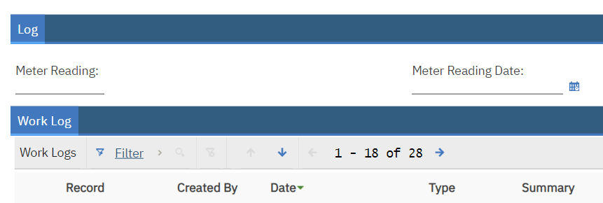

gail smith's profile image
gail smith
We used to record the actual meter reading the work was done in the work logs.  Depending on the piece of equipment, the actual readings could be recorded anywhere between weekly to yearly.  It was troublesome to read through every log entry on every WO to capture that data point on an Excel sheet.  So we add 2 new fields under the Logs section.  They're stand alone, do not affect the actual meters.  They're just there to collect data.
