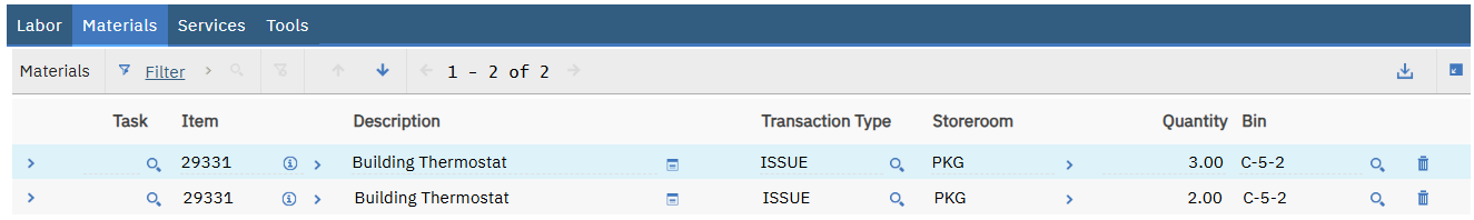

I had item 29331 with a balance of 3 @74.00 each as of 2015. Today in 2025, I ordered another 10 @ $80 each.  I then issued 5, which was split automatically to consume all 3 of the 2015 batch, and a further 2 of the 2025 batch.  This is expressed as two transactions.
NB: On the Inventory, the inventory cost section after receiving the 2025 batch had two records, however, after issuing the 5, it now only shows the 2025 row.  This is because all of the 2015 batch has been issued.
Let's recap.  In 2015, I ordered 3, then in 2025 I ordered a further 10, then consumed 5.  For the work order, it means nothing for maintenance to know the PO that topped up the quantity in the store.  Taking on the fact that once the inventory cost is removed once that batch has been consumed makes tracking even harder.
