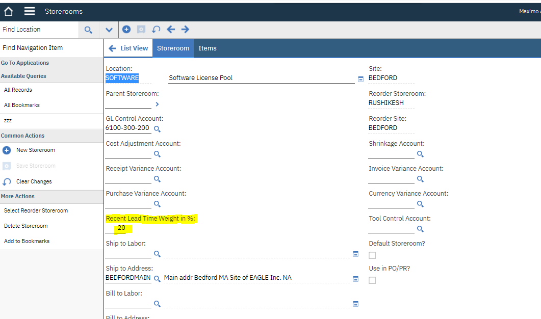

2. An important parameter present in the storeroom application which plays a key role in calculating the lead time value. That field name is Recent Lead Time Weight expressed in percentage(%) on Storeroom application as shown below. The Recent Lead Time Weight in % calculation shown above operates on 1 receipt at a time, in sequential order of the receipts.

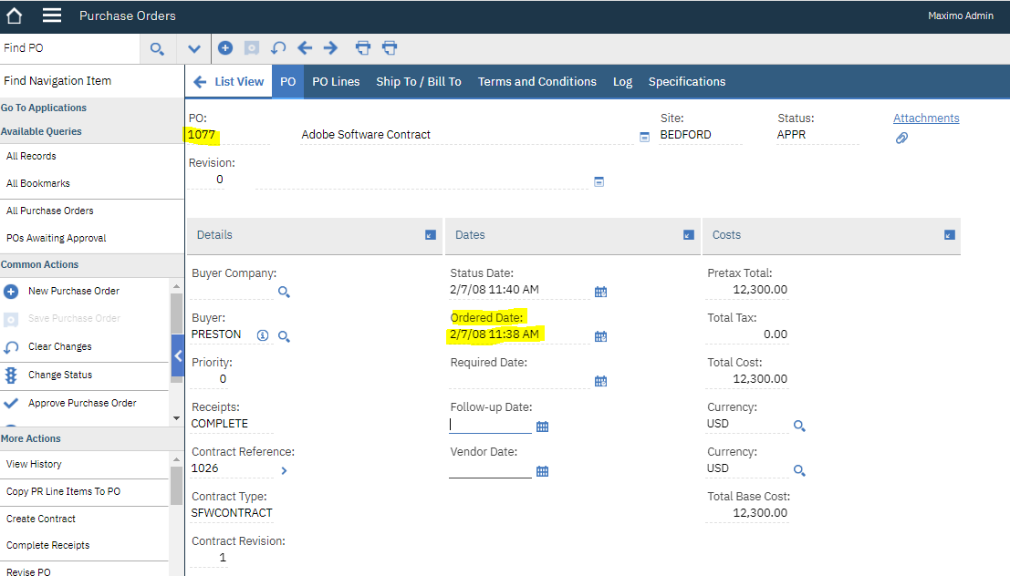

3. A PO for that ITEM with ordered date as below.

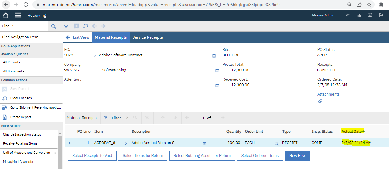

3. The delivery date from receiving for the same PO as shown below.

rltw = Recent Lead Time Weight in % (Screenshot 2) = 20%
poOrderedDate = Order Date as present in PO Header (Screenshot 3)
deliveryDate= Actual Date from Receipt record for the same PO (Screenshot 4)
