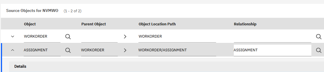

If I add the assignment object to the NVMWO object structure
And submit the same request, it now processes successfully and updates the assignment. Instead of using rel.assignment{laborcode,craft,laborhrs,assignmentid} in the select I can also use assignment{laborcode,craft,laborhrs,assignmentid}. This is the object name (not relationship name) which ensures that if the relationship is later changed you'll continue to use the proper relationship. It's important to be aware that even if this was part of the object structure, if you retrieve it using the rel. notation it will never be updateable. You would need to use the objectname{} notation to get the necessary data.
You then declare the child datasource as an attribute without using the getChildDatasource function. This is required to setup the datasource properly.
