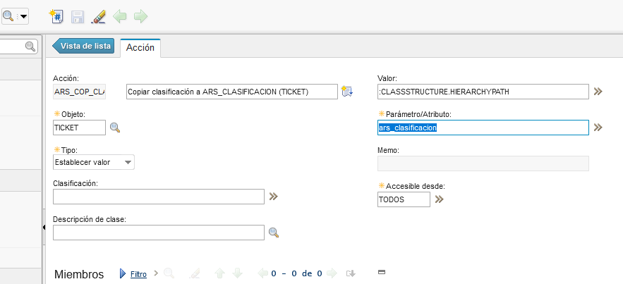

Martin Fabra's profile image
Hi Phillip!
I've been checking. What they have configured here is that they created different escalations on different objects (SR, WORKORDER) and where they check if classstructureid exists and ars_clasificacion does not exist ("ars_clasificacion" is a field they created in different tables to copy the description of the classification). For example, the escalation on TICKET says: ars_clasificacion is null and classstructureid is not null.
Then they execute an action of the type "set value" and in the value define it has loaded ":CLASSSTRUCTURE.HIERARCHYPATH" and in parameter/attribute it has loaded ars_clasificacion. In this way, when the escalation is executed, it updates the ars_clasificacion that you can then use to export to excel or report, etc. Can it be improved? Yes, with a script... but they solved it here (I didn't do this... it's very old).
