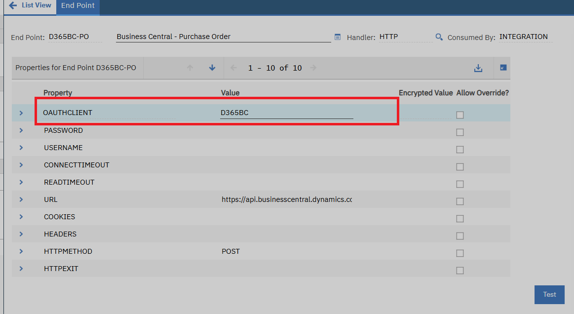

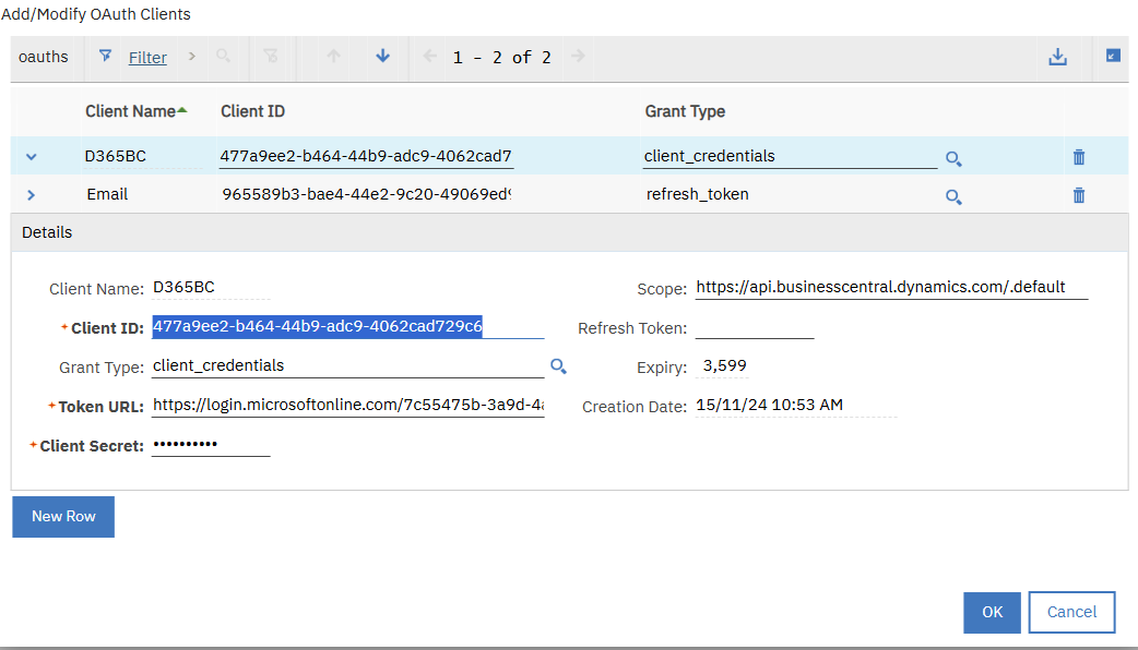

What external system are you looking at? If it supports OAUTH, Maximo now has the OAUTH client which you can use directly in the HTTP Endpoint.
Below is an example on how to connect Maximo with Microsoft Dynamics.
The OAUTH client automatically refreshes the token when it is expired.
If you want to use the OAUTH client in your custom code, simply access it as follows:
