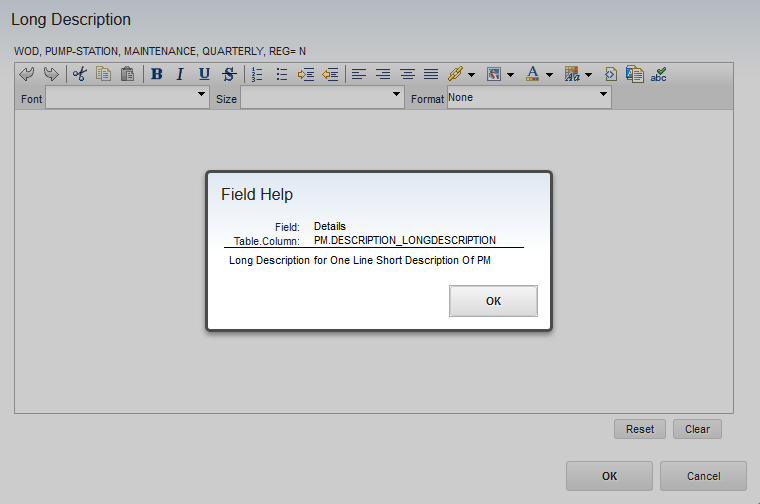

siteid = 'WODM' and
exists(select null from longdescription where ldkey=pm.pmuid and ldownertable='PM'
and ldownercol='DESCRIPTION' and ldtext is not null)
