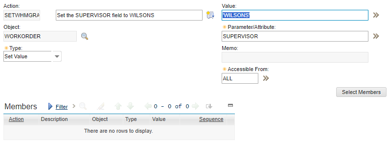

2) Create an Action.  The type would be 'Set Value' and since you're assigning a static string value, use single quotes, something like this:

In the middle, you have to have at least one Escalation Point.  Each Escalation Point then has its own Actions and/or Notifications. So with the Escalation Point row clicked on/"in focus," you would (in our example) use the Actions table to add the Action you created in Step #2 above, then on the Notifications tab add the Communication Template record you created in Step #1.  Then from the Maximo Actions menu/sidebar, choose Validate (just to make sure there are no syntax errors) and then choose Activate/Deactivate.
