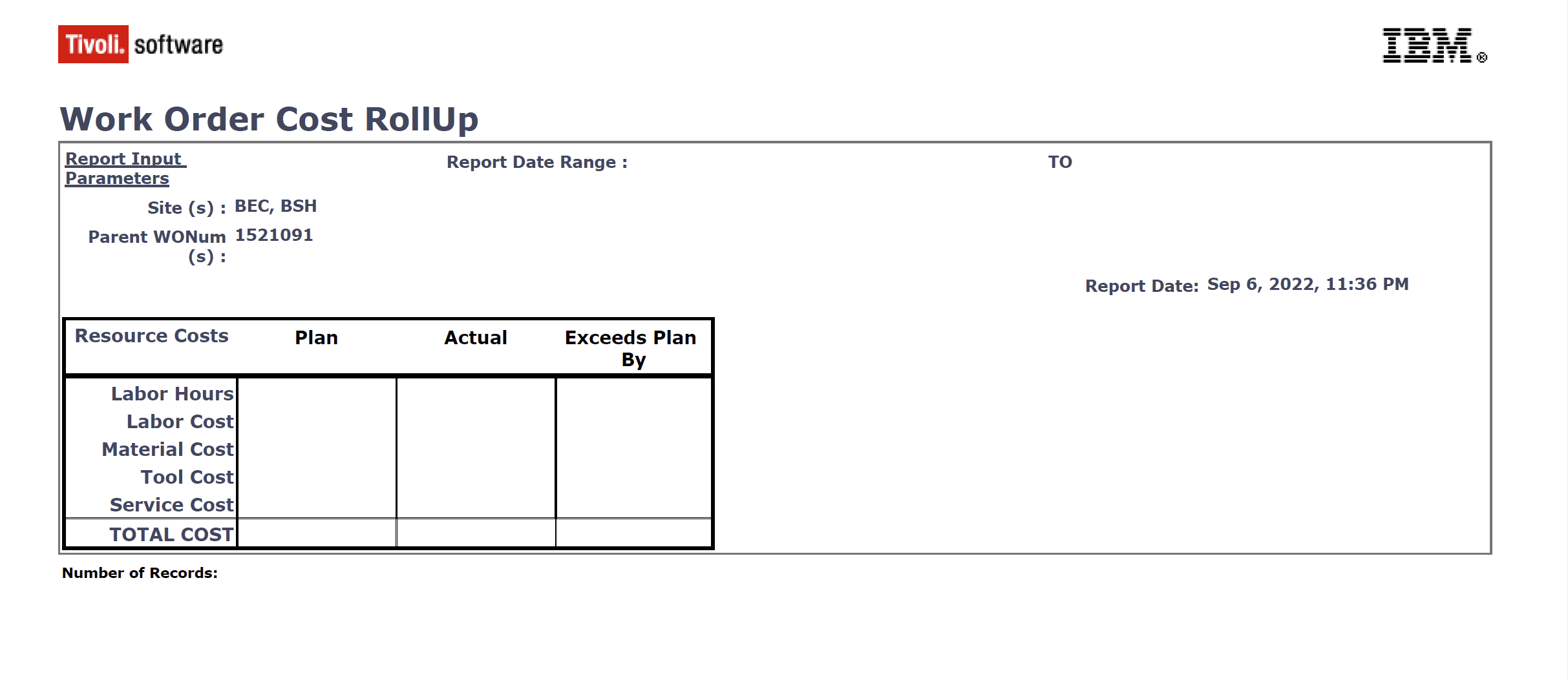

Norma Ramey's profile image
Norma Ramey
Hi Keith, I have to check if it was an out of box or custom report, but I did find this in my files. It has the old 2 image IBM header so older version.  I know IBM retired a bunch of reports also.  I might still have the .rptdesign that would require a few tweaks.
