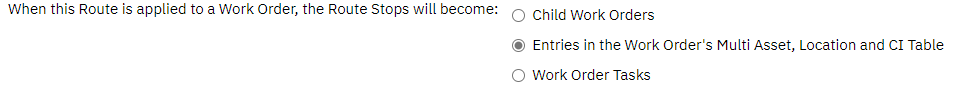

Route: offers the choice of the children being full WOs, Tasks, or a simple list in the MultiAssetLocCI table (which then may have an impact on how you count 'asset touches', how the WOs get assigned, how you record parts and labor to the children, how you track the status of the children, and so on)

Firstly, I would "use a route to generate a work order" as that is not a true statement.  Why?  This is because only one of the three options when the route is applied to a work order will be work orders or rather child work orders.
It is unusual to apply a route to a work order, rather you would use it on a PM
A route is simply a method to apply multiple assets or locations to a work order either as child work orders, tasks, or Multiple Assets, Locations and CIs.
