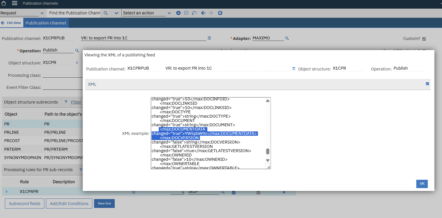

Sergey Melnikov's profile image
Sergey Melnikov
I added doklinks to the object structure, generated XML, then went to the publishing channel and generated XML. The field appeared there, but it wasn't in the XML message.
What else should I do?
