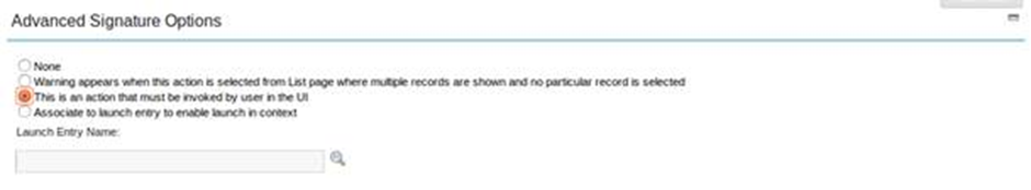

- Create sigoption for above mxevent name (LAUNCHDIALOG) in the application from where we route the workflow. From advanced signature option enable this option.
3. Create an automation script with action launch point for above mxevent/sigoption (LAUNCHDIALOG) with below logic. The object here is: COMPLETEWF (which is the object behind the task node dialog)
