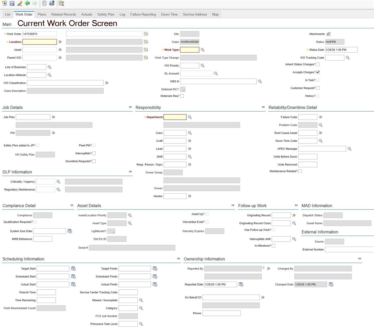

    Here is our current v7.6 Work Order Tracking screen as an example:
    v7.6 Work Order Tracking, general screen that several groups use

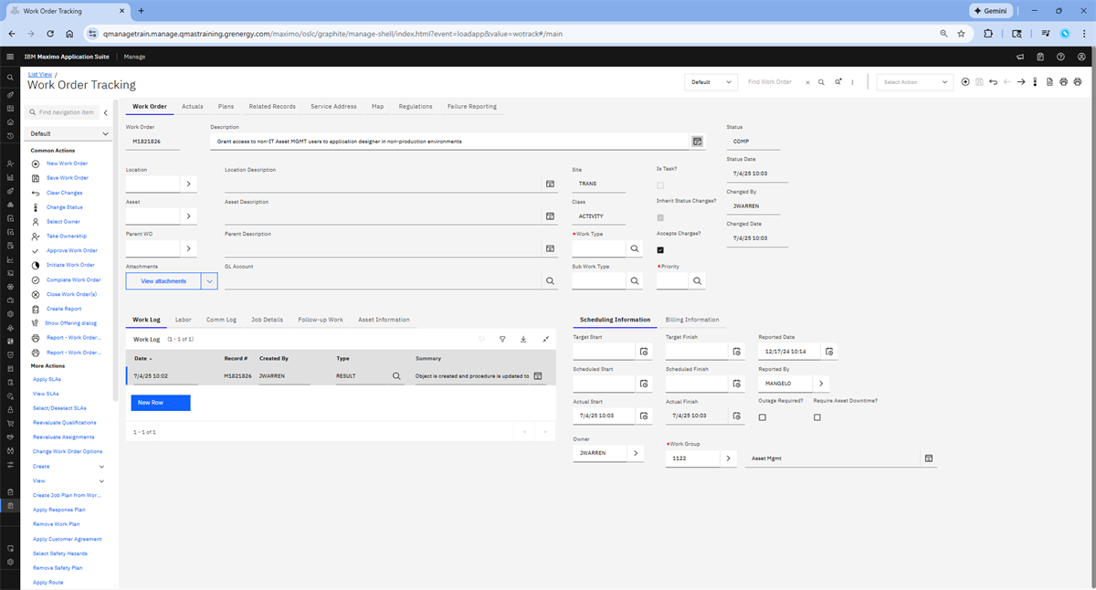

    Here is the MAS 9.0 equivalent.
    The v7.6 WOTrack screen has like 2 fields below the bottom of my screen while the MAS 9.0 makes me scroll down 3 pages to see it all.  If we are talking comparable values the body of the form for 7.6 is 1,100 pixels high while the 7.6 one is 2,650 pixels high.   It takes 2.4 times more space our v7.6 counterpart.  And that is not factoring in the large empty spaces at the top of the forms.  The space around the fields is excessive, the height of the fields is often 3 times what is needed for the data in the field.

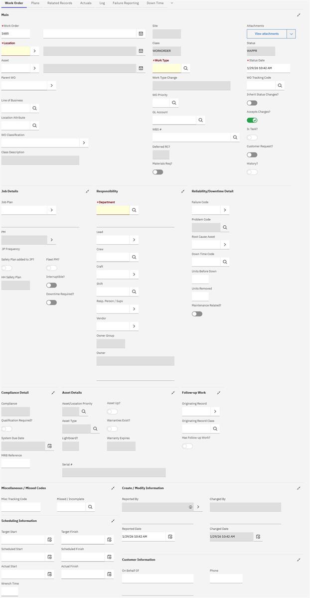

    We found it necessary to "rework" most of our field-heavy classic screens (WOTRACK, ASSET, etc) simply because even CSS edits were not enough to eliminate scrolling.  Most of the "rework" involved either moving stuff around and resizing fields, along with the use of tab groups.  We did also update our CSS to (we think!) greatly improve the look-and-field of Manage.
    Out-of-the-box look and feel
    Modified look and feel
    Jade Warren

    I will look at what you did but it is an improvement between 10 - 20% and I need something on the 100-200% range.
