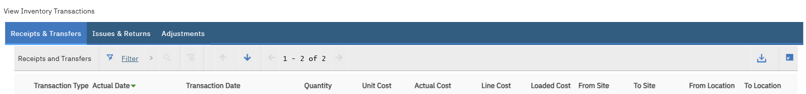

    Hello MORE Maximo Community,
    I am attempting to locate the Receipts and Transfers Tab in Application Designer.
    I am thinking I could find it by clicking the "Edit Dialogs" button in the correct Application, but so far I have searched in Inventor and do not see it.
    Any help is greatly appreciated.  Thank you,

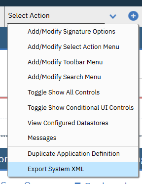

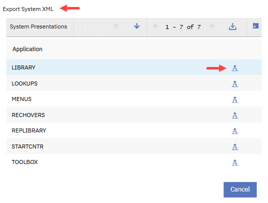

    Hi Danny,
    From the inventory application, try using the "Export System XML" action then select "Library". Once the page opens, use Ctrl F and search on "receipts"

  • 3.  RE: Receipts and Transfers from "View Inventory Transactions" in Application Designer.
    Posted 12-06-2024 09:40
    Thank you @Steve Norris.  I was exporting the Application Definition instead of the Library.  I was able to locate and add, but am unable to locate the button to import the new XML.

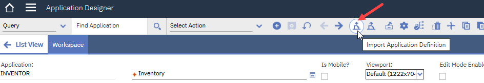

  • 5.  RE: Receipts and Transfers from "View Inventory Transactions" in Application Designer.
    Posted 12-09-2024 11:43
    Thank you again, @Steve Norris.  The change was successfully implemented.
