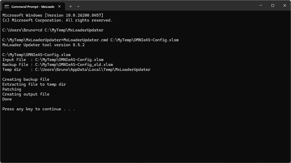

  • 6.  RE: Cannot download doclinks attachment using the MxLoader 8.5
    Posted 05-26-2026 12:04
    Download the latest MxLoader Updater tool from here.
    Extract in a folder of your choice.
    Open a Command Window and change current directory to where you extracted the tool.
    Run the MxLoaderUpdater.cmd command passing the full path of the MxLoader file to be upgraded.
    It should look like that.

  • 7.  RE: Cannot download doclinks attachment using the MxLoader 8.5
    Posted 05-26-2026 17:24
    Thanks a bunch @Bruno Portaluri looking into this and fixing the issue.👏👏 I was able to download the doclinks attachment with the MxLoader. 8.5.1.
