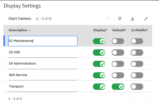

    Hi Venkat
    Just to visualise.  This is the before.
    This is the after.
    This is the change that was made.  Specifically, I added a number in front of the description.

  • 4.  RE: Want to change the start center order
    Posted 02-17-2026 08:32
    Thank you for the reply Craig, this helped.
