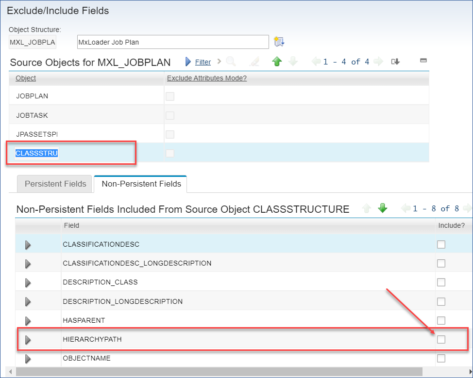

      |   view attached
    Hey Kimberly,
    Looks like you may need to check the "Include" box on the MXL_JOBPLAN object structure. Please see the attached image.

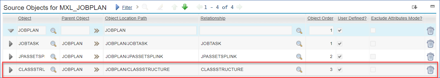

  • 6.  RE: Job Plan, CLASSSTRUCTURE.HIERARCHYPATH
    Posted 11-16-2021 17:37
    I think you will need to add CLASSSTRUCTURE under the Source Objects for MXL_JOBPLAN, first.
    Then, you should be able to see the HIERARCHYPATH

  • 7.  RE: Job Plan, CLASSSTRUCTURE.HIERARCHYPATH
    Posted 11-17-2021 11:24
    Thanks so much for the clear instructions. I made a rookie mistake and forgot to first select classstructure before looking for the non persistent fields.
    With your screen shot, I was able to see and select them, and they now come down to my mxloader sheet.
    Thanks so much for the assistance!
